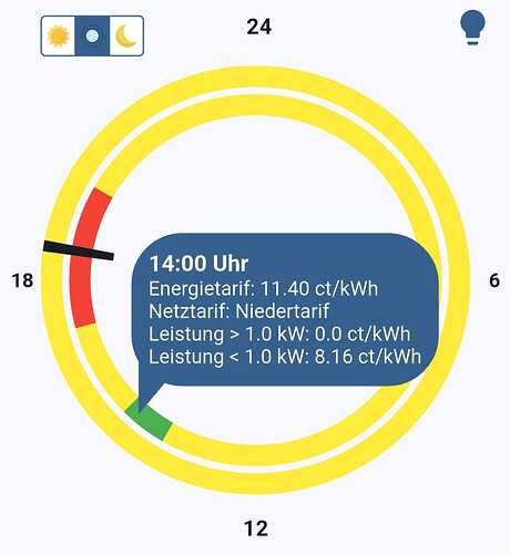

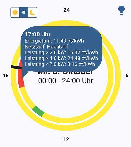

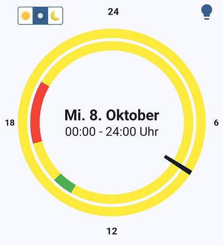

The variable gridfees currently being tested in Austria not only vary over time, but also include a power component:
most time during the day a fixed gridfee:
However, low and high fees are also power-dependent:
Is it possible to implement something like this also?
This is getting pretty complicated. Discounts for taking more power during low tariff and penalties for higher power during high tariff?
Yes!
Why create such complicated rules? So that no one can enforce them? And I thought that was a German specialty.
