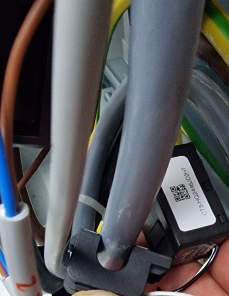

Is there any possibility to get bigger CTs for the VM-3P75 energy meter?

This will not work. You have to use a single wire and not the complete cable with L, N and Gnd
This is single wire. There are 3 of them on a 63A Fuse.
You need to strip the YMVK cable i.e. remove the gray outer insulation and put the CT clamp over the brown wire (which sometimes is black by the way) as shown here:
Also. You may need the usual grey conduit, properly secured to the wall like every 30-50CM (depending on the orientation).
Note: do NOT strip the brown/black wire!

I can´t strip anything here. Thats a three phase System. I have 5 of this cables. Grey, black and brown are L1, L2 and L3. Every single cable is too big to get a CT on it.

Aha. Ok. Sorry. Was still early for me. We here are used to the grey multi-core cables. Also used for 3 phase systems. Like 5 x 6 mm² or 5 x 16 mm²

Maybe press the wire flat a bit, so it becomes more oval instead of round ?
As a last option, if the cable is just a tiny little bit too wide for the current clamp, would be to cut away the inner plastic of the current clamp.
This would obviously void the warranty of course.
I was very disappointed when my VM-3P75CT arrived with the small CTs. Following some research, I crossed the Victron supplied numbers (Tokin C-CT-0810-05-01) to a 3000:1 datasheet. Then I found a 80-C/CT-1216 from Mouser electronics. I spliced some extension wire to end up with about the same length and my meter is in business. Yes - I can’t call it Victron calibrated, but it does compare nicely with my installed Scheider system. The Victron energy meter is very responsive. Consider me a satisfied customer (now).
