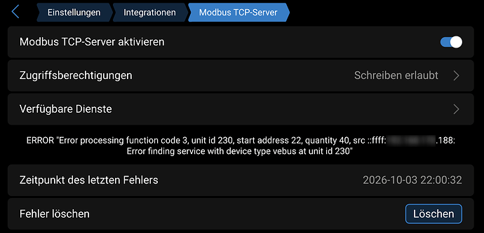

I happened to come across this error in the Modbus settings. I can delete it, but it then reappears automatically!

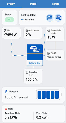

I can see in VRM that there’s surplus power! The values are negative and, during testing, well over 6–7 kW.
Controlling the Wallbox via the CerboGX seems to work.
For example, when I change the mode, the Wallbox accepts it!

I’m still seeing this error:

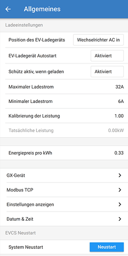

Could you show a screenshot of the VRM and the EVCS settings?
Is communication between the GX device and the EVCS working, though?
In other words, are the system’s current values shown in the EVCS web interface?
Is the PV inverter being read and displayed by the Victron system?
A negative reading from the grid sensor alone isn’t enough; the EVCS needs to know the PV output.
The PV inverter is not visible in the Victron system.
