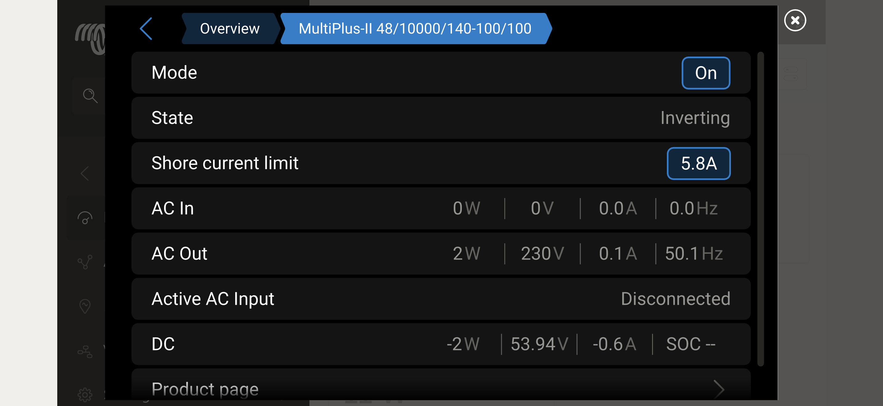

Well interestingly i updated the firmware to venus os large today as i was going to play with node-red and now i can set the shore current limit to 5.8amp and it stays - so if this right we should be fine… Going to test it this week and see what happens
