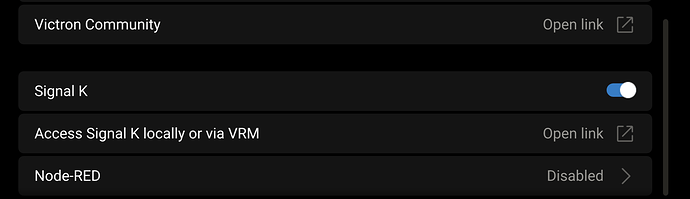

I have Ekrano GX with VenusOS Large 3.66 installed. I have enabled SignalK but Node Red is disabled.

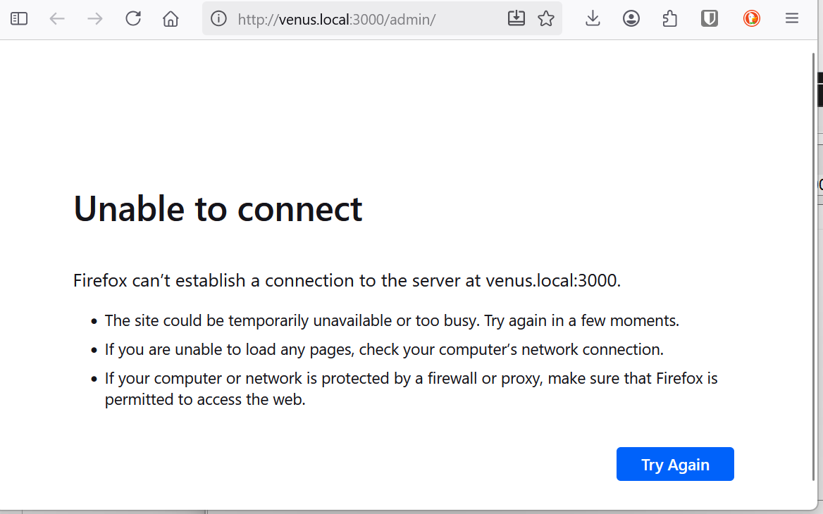

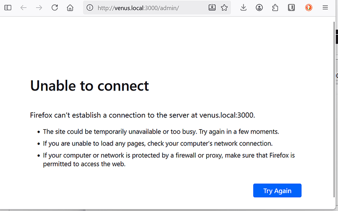

Signalk is not reachable by any URL (e.g. http://192.168.253.110:3000 or http://venus.local:3000 or by clicking openlink in the remote console).

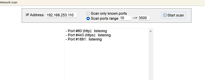

A network port scan shows that the port 3000 is not open on the Ekrano, screenshots below show this.

I have tried different web browser and have also cleared all history and cache of the browser.
