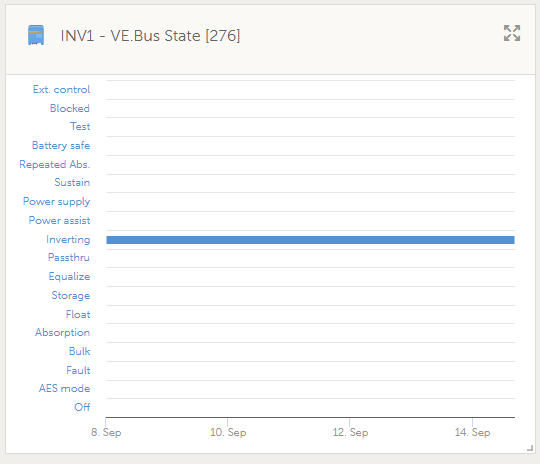

VE.Bus State
My system has on-grid inverters. When batteries need to be charged.
On-Site physical information in front of the multi plus II Panel
Giving information with the green light that it says “inverter On”
And with the charger bulk light it give information that it is “Charging“
On VrmSite
It only says “Inverting“
But when you check the Vrm site the Ve.Bus state has information like charging also.. But it has only 1 attribute. It cant show Inverting and charging state at the same time.

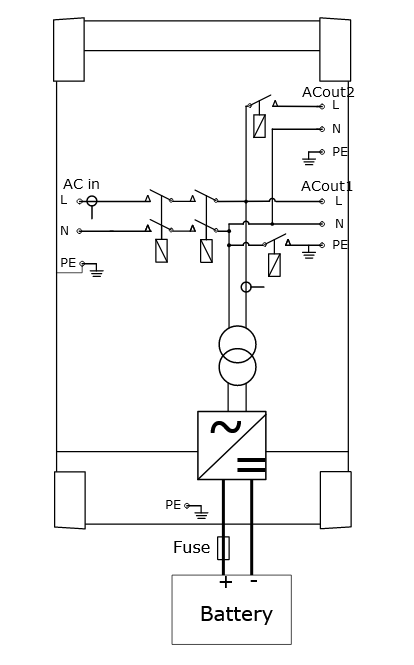

A Multiplus has only 1 ac/dc converter, used ac to dc to charge and dc to ac to invert. It can not do both at the same time. It DOES NOT have separate charging and inverting circuits

Ok I Get it.
Still this doesnt explain why when Multiplus II is charging the over power from Ongrid to batteries it doesnt show up on the VRM. But on the Unit it shows the charging LED in ON.
