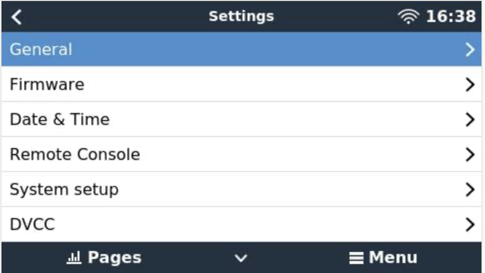

Settings menu without the problem:

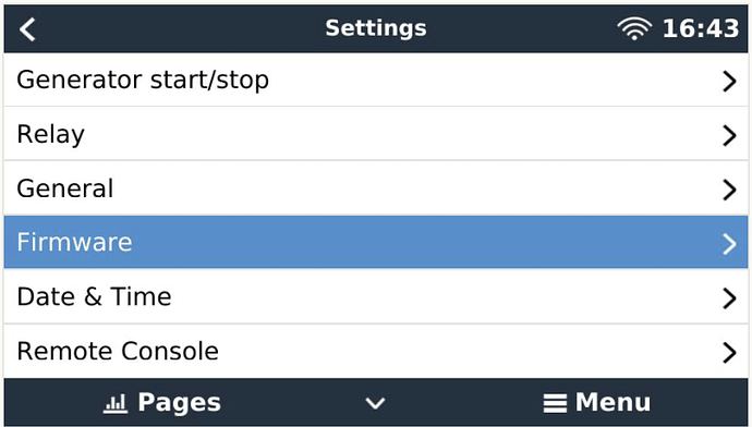

Settings menu showing ordering error
/etc/venus/gpio_list is filled in causing this (after reboot)

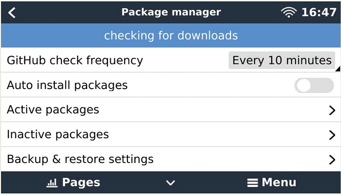

Package Manager menu as it should be (v3.63)

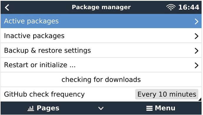

Package Manager with issues

I’m not sure that the issues with the Package Manager menus are the same cause as the jumbled Settings menu since they don’t straighten out by removing gpio_list.

Alex seems to be mostly correct about show. In PageSettings, Generator start/stop, Relay and I/O have show statements. The first two appear at the top of the list rather than farther down in the list. However I/O is at the bottom where it should be.
show also affects ordering in my Package Manager menu. If I comment out the show: lines, then the menu renders in the order of objects in the .qml file.
I ran some tests to see if show changing state affected menu order and it does! When show for an item goes true, the menu redraws at the top of the page.
