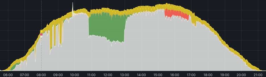

Use Venus OS Node Red to run the battery grid friendly
I have a Multi plus 3000 a small 2kWp DC coupled and a large 12 kWp PVsystem with a 9.6 kW pylon tech battery 48V. I live in Germany and have an electricity contract with a fixed price per kWh, so an ESS system does not make to much sense. With growing renewable energy we face the problem of higher grid load, but the battery of privat PV system are not used grid firiendly. The charge excess already in the morning, when everybody needs power to make coffee or whatever. The battery is charged already at noon, when the excess PV power in summer is overloading the grid.
My constrains were:
  • load as late as possible in the morning
  • make sure the battery is charged in the evening, even when it gets cloudy/raining in the afternoon
  • avoid feeding DC excess into the grid
Watt do the Nodes do:
They ask for the SOC of the battery

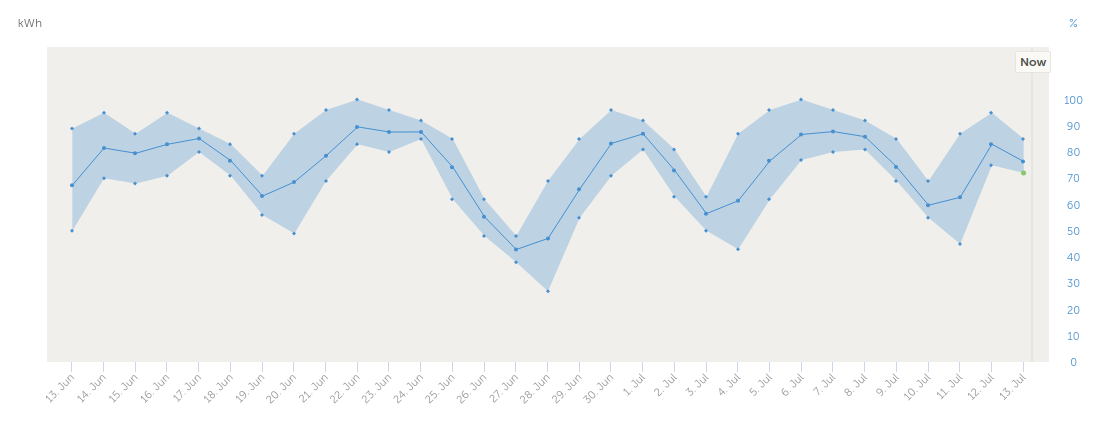

They ask once for the daily PV yield forecast (2 options Victron forecast or solforcast)
They ask for the current PV yield of the DC system

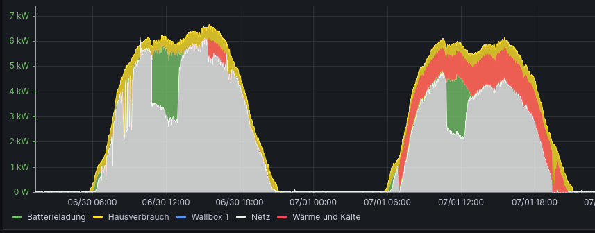

from 6:00-9:30 h it is asked, if the SOC is above 25%, so there is some residual load, if the PV yield is not high enough to run my coffee maker. If SOC above 25% it asks, if PV yield forecast is above 22 kWh (10 kWh for the battery and 12 kWh for the typical house use in my case, to be adopted). If both is OK, the charge power is limited to the DC load and AC excess is charged into the grid.
at 9:30 h the charging power to the battery is limited depending on the SOC of the battery. I calculated, that the charging time from every 10% step takes approximately 5 h to charge, so the battery is charged at 14:30 h latest.
at 13:30 h the program ends and the maximum capability of the multi II is used to charge the battery.
I run that during the summer and had all days with not sufficient PV yield covered.
I put the code in here, but as I am not an IT expert, I can not run a GitHub page and can only give limited support.
what you need to change is the “site ID” in the solar forecast node you find it, when you open your VRM Portal and click on the https address in your brother: You see something like VRM Portal - Victron Energy the number you find in your installation instead of the 1xyz45 is your site ID. The rest should work.
There is an alternative forecast, which I used up to know, which is still included in the node. I owe some thank you, for the one, who wrote it, but I do not know, where I got it from. it gives still a forecast, but in this Node you have to insert your location (I changed it to Kassel Germany with a 25° south PV of 10 kWp)

Aktuell scheitere ich an einer sinnvollen Ausgabe des Solar forcast dessen Einrichtung Du beschreibst. Ich habe das wie auf dem Screenshot zu sehen angelegt und auch den Token generiert und eingetragen. Aber was muss ich im Feld “Installation” eingeben, damit die Solar forcast Daten ausgegeben werden?
Hallo Frank,
Hier der Screen Shot, da hatte ich gehofft, dass das mit kopiert wird. Ich bin leider nicht viel besser als du mit NodeRed. Aber wenn ich es hinbekomme…
Funktioniert eigentlich der API link im Beitrag vor deinem?
Viele GrĂĽĂźe
RĂĽdiger
:sweat_smile: Zwei Blinde suchen das Korn.
Also ich habe das nach Deiner Beschreibung und dem Link soweit zurecht gebastelt und es scheint zu funktionieren.
Ich hätte allerdings damit gerechnet, dass die Ausgabe im debug node der Zahl des mittleren nodes entspricht.
Vielleicht kann ein Wissender mir die nötige Änderung nennen, die dafür durchgeführt werden muss.
Forcast Flow
Lass dir die gesamte Ausgabe des Debug-Nodes mal im Debug-Fenster ausgeben, dann wirst du sehen, dass der VRM-API Node nicht nur eine Zahl, sondern ein ganzes Objekt liefert mit einem Array fĂĽr die Solar-Prognose jeder einzelnen Stunde als auch dem unter dem VRM-API Node angezeigten Total-Tagesertrag.
Du kannst dann beispielsweise mit einem Function-Node und javascript die einzelnen Teile rausholen, die du benötigst (Stundenwerte, Tagessumme, …).
Dieser Function-Node liefert beispielsweise ein Array mit jeweils 90% der stĂĽndlich prognostizierten Werte:
Gibt sicher auch Wege ohne javascript, da ich aber aus der Hochsprachen-Programmierwelt komme, ist mir JS sympathischer als Verkettung unzähliger Nodes…
Und dieser Change-Node “Total” liefert dir die Gesamt-Tagessumme als Zahl:
Vielen Dank für die Erklärung und die Lösung. Das habe selbst ich verstanden (nicht die Java-Programmierung).
Ich habe noch einen function node danach eingefügt und schon habe ich den Tagesertrag ohne Nachkommastellen. Mein Akku ist groß genug (hoffe ich), um nicht mit stündlichen Erträgen rechnen zu müssen.

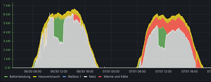

Update:
FĂĽr alle die es interessiert, hier ein kleines Update dessen, was ich inzwischen gemacht habe.
Anmerkung:
AkkuV: Maximale Akkuspannung
MaxA: Maximaler Akku Ladestrom
Erläuterung der Idee:
Dem Pareto-Prinzip folgend möchte ich mit überschaubarem Aufwand eine 80% Lösung schaffen.
Dieses Konzept ist auf meine Victron Anlage ausgelegt die nicht der Mehrheit der verbauten Anlagen entspricht. Ich habe Module in alle Himmelsrichtungen mit diversen Neigungswinkeln installiert. Kaum ein Modul ist ganztägig unverschattet, weshalb ich überwiegend mit Modulwechselrichtern und wenigen MPPT arbeite. Die gesamte Anlage hat aktuell rund 15kWp, soll aber noch um rund 5kWp in Südausrichtung erweitert werden. Daher sammle ich schon jetzt Daten um die 60% Regelung erfüllen zu können. Einen Mittagspeak wie bei klassischen Südanlagen gibt es aktuell nicht.
Grundsätzlich: Akkuschonung vor Netzschonung
Auf Grund finanzieller Nachteile (Wandlungsverluste) soll der Akku nicht in das Netz einspeisen.
Die Änderungen der Einstellungen erfolgen nicht genau zu den Stundenwechseln sondern zu “krummen” Uhrzeiten wodurch das Netz weniger belastet werden soll.
Die größten netzweiten Unterschiede zwischen Produktion und Bedarf gibt es Sonntags (und zum Teil an Feiertagen). Daher erfolgt eine komplette Vollladung des Akkus incl. Balancing am Sonntag. Zur Wochenmitte wird die maximale Akkuspannung von Tag zu Tag abgesenkt um den Akku nicht lange Zeiten voll geladen herumstehen zu lassen. Zum Wochenende wird sie täglich wieder angehoben. Je nach Jahreszeit und Wetter erreiche ich damit mindestens 1x pro Monat ein Balancing.

Die Grafiken zeigen den Akku SOC Verlauf der letzten 30 Tage so wie die Verteilung des solaren Ertrages an zwei beispielhaften (sonnigen) Tagen so wie im Detail am 30.06. incl. Uhrzeiten. Gut zu erkennen ist, dass der Akku ĂĽberwiegend in der Mittagszeit den solaren Ăśberschuss aufnimmt.
