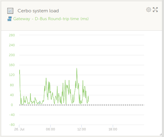

Seems I have to change from Cerbo to Ekrano. CPU load is probably caused by big image to transfer SunSpec data from Ziehl relais. Try to increase polling intervall from 1 second to 5 or 10 seconds, maybe adding more memory or other solutions?

Jul 26 06:57:53 einstein daemon.err watchdog[555]: loadavg 7 7 6 is higher than the given threshold 0 6 6!
Jul 26 06:57:54 einstein daemon.err watchdog[555]: repair binary /usr/sbin/store_watchdog_error.sh returned 253 = 'load average too high'
Jul 26 06:57:54 einstein daemon.alert watchdog[555]: shutting down the system because of error 253 = 'load average too high'
Jul 26 06:57:54 einstein daemon.err watchdog[555]: /usr/sbin/sendmail does not exist or is not executable (errno = 2)

Or look at the mods or nodered flows you have, dial back polling intervals etc.
Sometimes mods just need an update.
If you run top, you should be able to see what is eating up the cpu time.
Try increasing the watchdog parameters first. Been there, done that, and my Cerbo GX has been stable ever since.
Of coarse, its NR as its JavaScripts are super inefficient. Sometimes dbus_systemcalc jumps to top. Probablity of reboot seems a beat frequency problem of those two. Maybe gui_v1 will save some percents? Another thing to try is always closing the NR editor tab after deploy.

NodeRed is high, but on average the CPU is capable of coping with the workload. The watchdog sitting at 6 is too trigger-happy. I’ve set it to 10 and my htop currently looks like this:

What are you doing in nodered to push the cpu up so much?
There is probably some tuning that can be done.

To repeat myself: Average load is high, the watchdog does as it has been told and issues a reset of the system. Tweaking the workflows may or may not help, but if the CPU load is intermittent, load average will come down eventually.
In my experience, setting the watchdog threshold higher in its config file
/etc/watchdog.conf
can lead to elimination of reboots. If the workload is way too high, then other resolutions will be needed.
For more than a year now, I’ve been running the following settings:

Obviosly, Modbus TCP operations sometimes occupy many CPU time. After changing the data transfer from single scattered float values to 100 byte transfers, the occasional peaks in CPU time for NR seems to be less. Typical average of NR task is now about 15-20% CPU time. There is still one reboot about once a day.
Using vi (is there anything else in Venus?) I changed watchdog.conf. What are the values max-load-5 and max-load-15 and do I have to change both?
