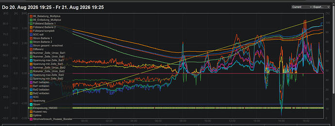

After a power failure i found that i had no local monitoring because the intenet failed too.
Not on my side but on the DSL connection point. So i started to pump all my data points into Influxdb. I then visualize everything via Grafana.

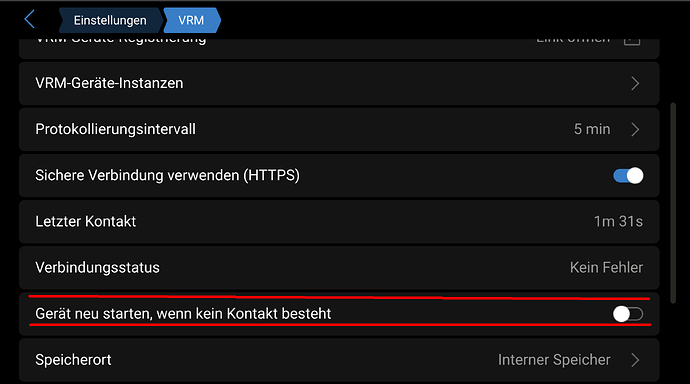

Even this setting is questionable and can cause problems if the internet goes down:

what do you mean? The logging? Yes, but that’s no comparison—it’s like a Polo versus a Rolls-Royce

Venus doesn’t crash for an internet outage. It will reboot if you configure it to.

I have numerous flows on my own system and if I drop internet access it will reboot in 1 hour, as it has been configured to do so.
