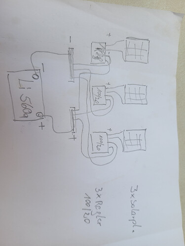

I’ve added a sketch.
I hope this is okay.

Hi, I can’t see any connection in the picture, or am I reading the picture/sketch wrong?
