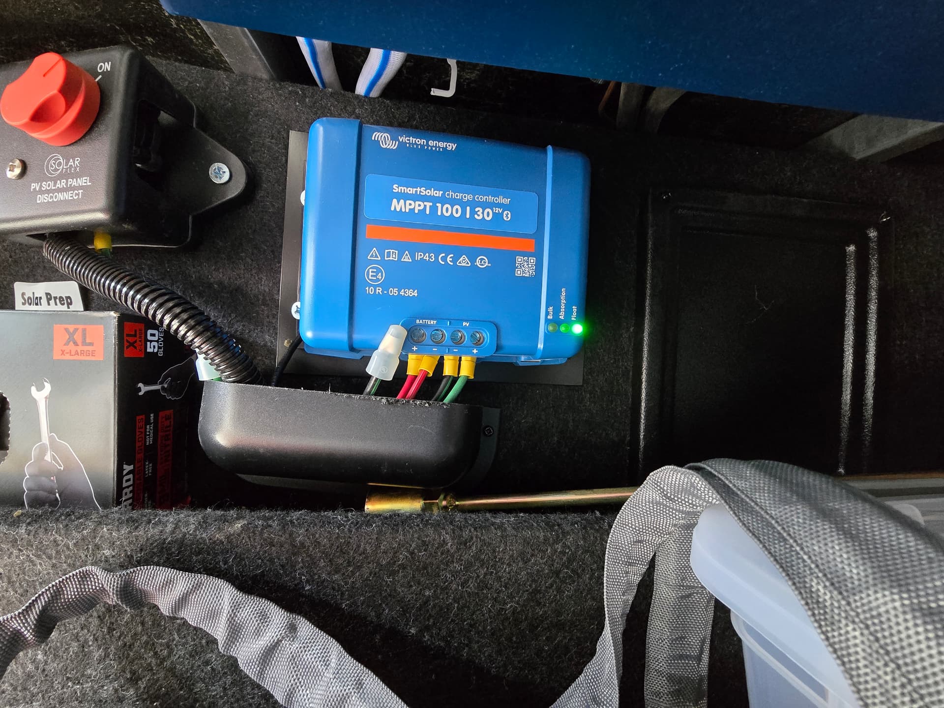

Smartsolar is not visible in my bluetooth device or does it seem to be charging batteries
I have the Smartsolar MPPT 100/30 bluetooth in my new travel trailer. right now it seems like the batteries are not charging. After doing a little research I see that I need to down load the app then I c
an detect the device to see what it is doing. However after downloading the app on multiple devices, all with bluetooth turned on the Smartsolar is not comming up on my device list. What am I doing wrong.

But who hast wiring it 2 Red on the battery terminal . Black and green with normal cable for pv thats realy bad.

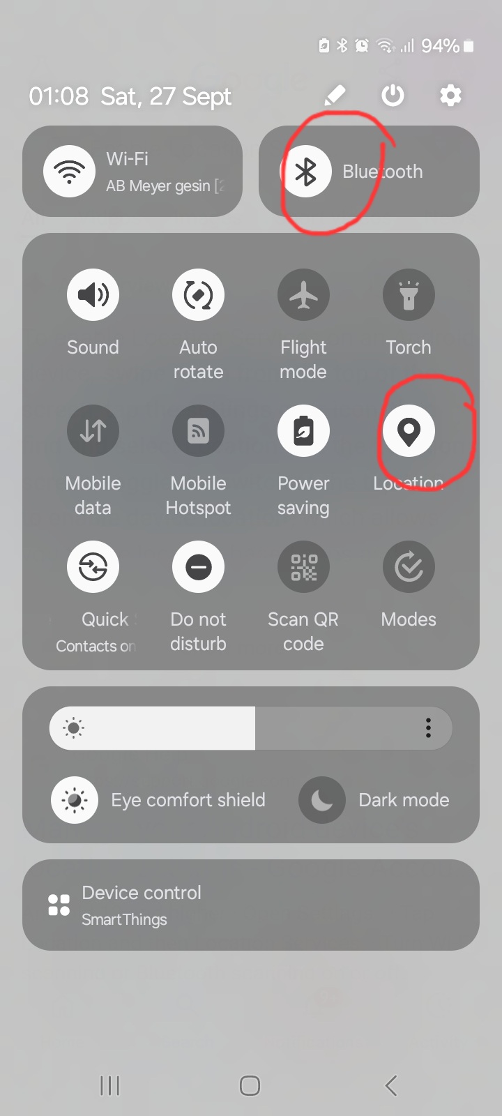

If you are using a Android device ensure Bluetooth and Location is turned on.
Yes they were, thanks for the help.
brand new 2025 cougar. Purchased made to order. Yes I saw that on the red wires as well. I have the USB coming tomorrow so I can plug in laptop.
