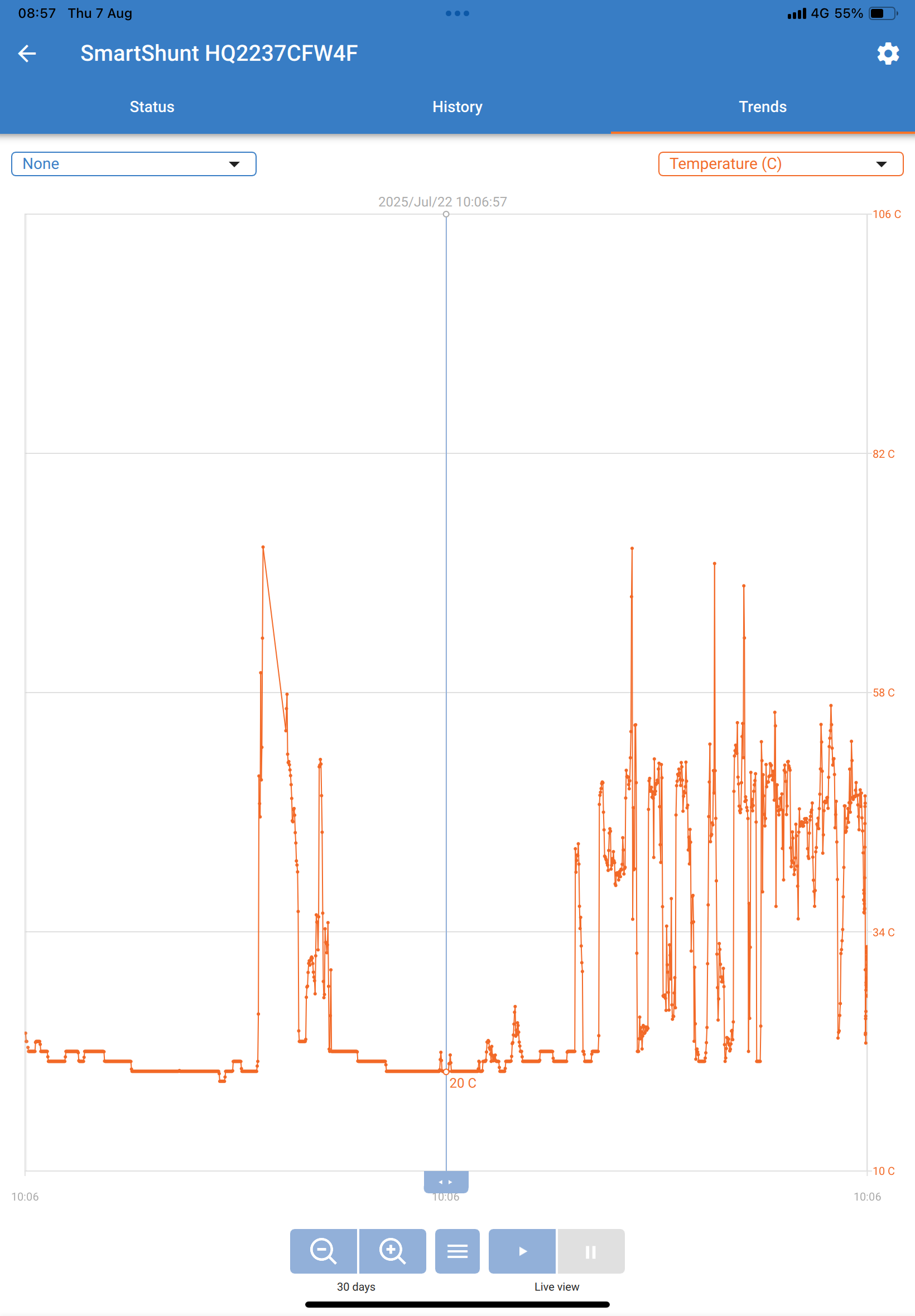

I have and IP43 12v 50A and a Smartshunt, which has worked fine. I am now sailing in a hotter climate so wanted temperature compensation. I bought and fitted a Victron sensor ASS0001000000 for BMV712 and Smartshunt. I fitted this sometime back but got no temperature reading. Yesterday I checked the sensor, it has blue sleeve on terminal and yellow caution label. After wiggling the connection into the Smartshunt it started working and IP43 said receiving voltage, current and temperature from Smartshunt. Today I thought I would check the battery temperature. There is no temperature reading attached is a plot showing temperature suddenly going to 90 degrees, I don’t believe this as the charger is in float mode with very low current into the battery.

It is reading voltage fine and terminal is tight. It was the push in cable on the Smartshunt that made it work yesterday. It has a crimped on ferrule so should be a good connection. I will remove it a remake the connection.
This is still giving me problems. I thought it was working fine but left my boat for a month, with a separate solar charger set to minimum absorption time, so tge battery had no discharge and just a very low trickle during the day. Attached is the temperature trace. The figures are ridiculous. Today I checked, the terminal was cold to touch and a IR thermometer measure 21C with boat internal temperature of 19C whilst Smartshunt showed 51C. I touched the wires and temperature went to 24C then open circuit then 50 then 24. I now have to conclude this is faulty, it has only been in circuit for about 2 months and never reliable.
