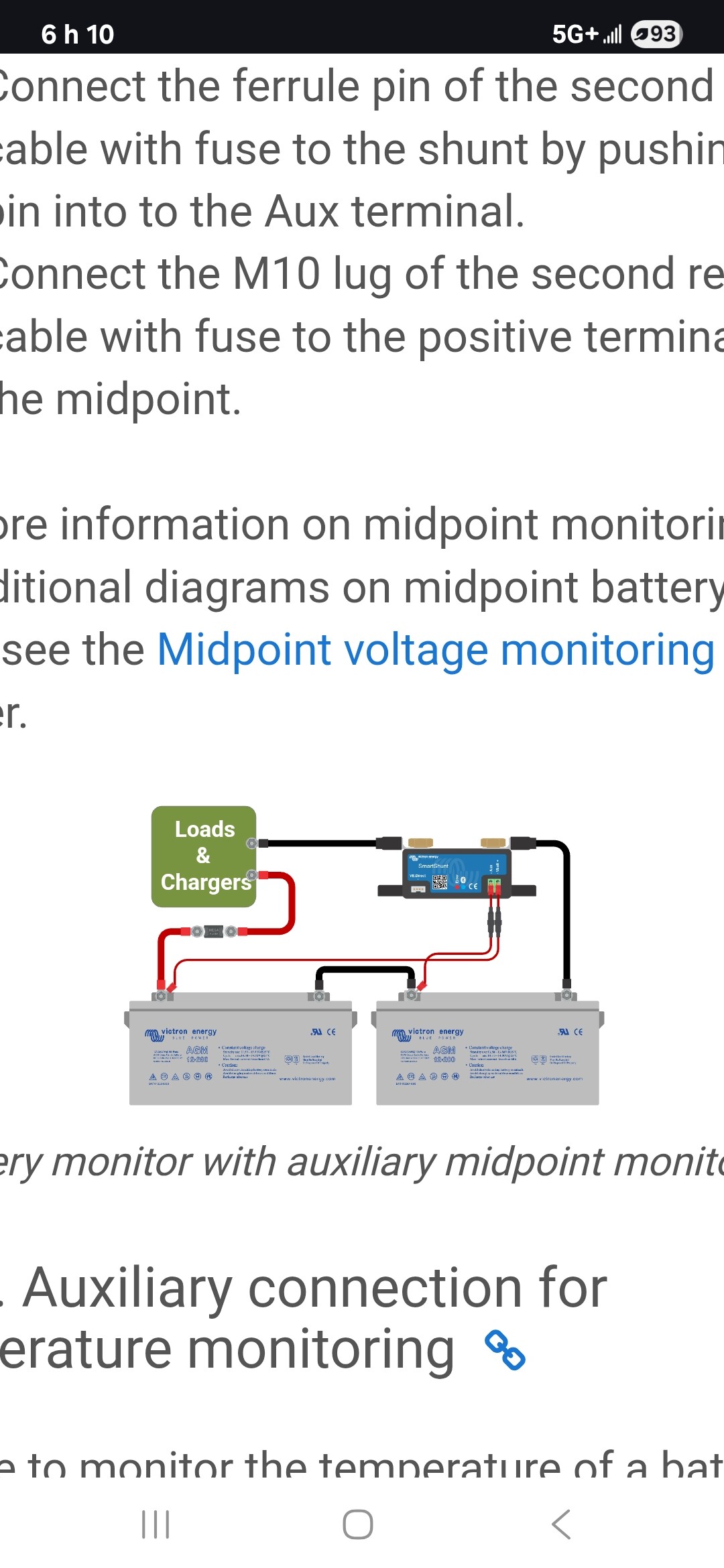

I have 2 set on battery 26v for house and 1 for starter i use the image showing for connecting my shunt
