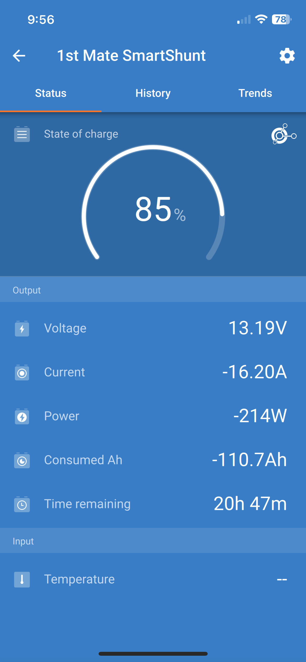

Hi, I have configured the temp aux setting on the 500A Smart Shunt however the temperature does not display. See attached screenshots of the setting and display output. I know the input works when I change it from temperature to measuring voltage so the fuse should be ok. The shunt is one of the newer ones with the hard-wired connections for battery, ve direct, etc. Any suggestions how to solve please?

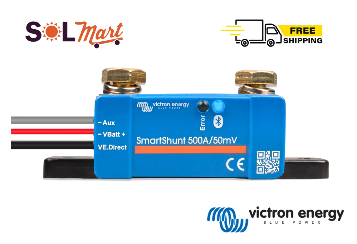

Thanks @Clark this is the new hard-wired version, no additional sensors required, see attached photo.
@Clark is correct, if you want temperature measurement you need the temperature sensor, this is not included. See Section 3.5.3 of the manual. You will have to connect this using crimps.
For use to monitor the temperature of a battery via the (not included) Temperature sensor for BMV-712 Smart and BMV-702 . This temperature sensor needs to be purchased separately. Be aware that this is a different temperature sensor than the temperature sensors that are included with Victron inverter/chargers and some battery chargers.
