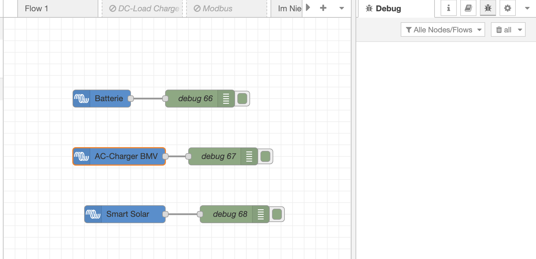

Just installed the node (1.2.0) on a Ekrano GX. It is running V3.60, I entered ID and Decryption Key (copied over from the VictronConnect App to avoid any misspelling) for a Smart Battery, a BMV and a SmartSolar MPPT Charger and hooked the output to a debug node, but get nothing in Debug:
I get all the Instant Readout on my Phones (iPhone and Android) as well as in VictronConnect running on my MacBook.
What am I doing wrong?

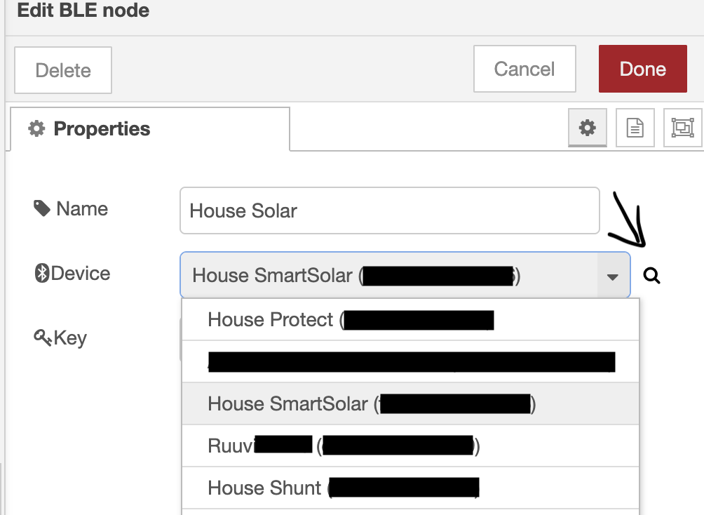

Hi, thanks for the quick answer, and SUCCESS!! :+1:
I didn’t even have to upgrade my Ektrano to v 3.63 the trick was to click on the magnifying glass, and then select the device again:
Immediately afterwards, data was flowing to the debug node:

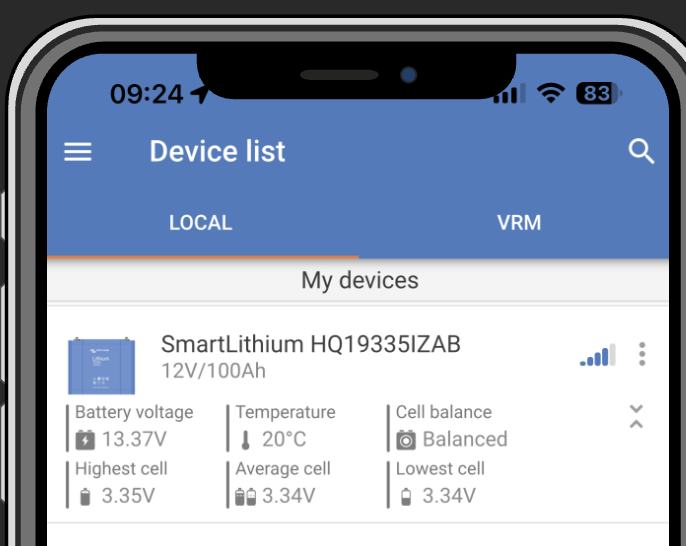

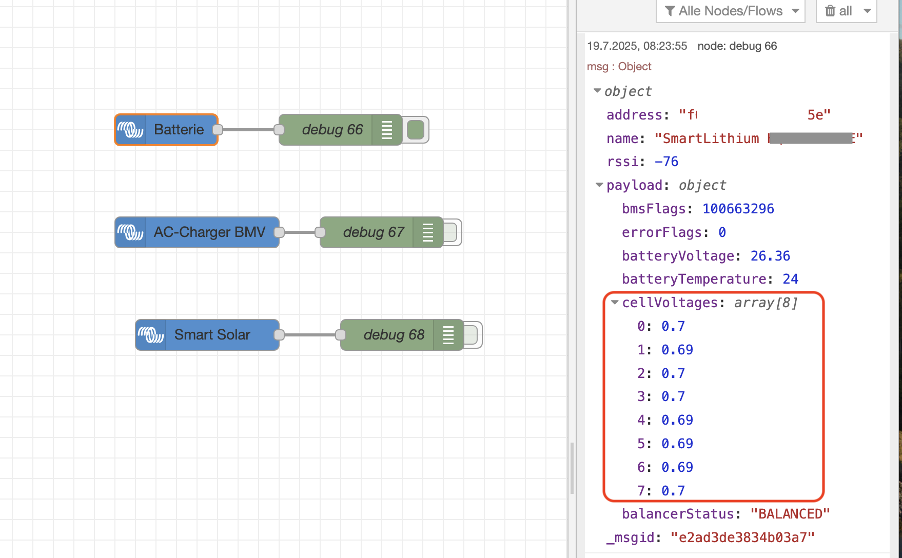

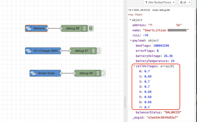

As you can see from the Screenshot, the Cell Voltages Array seem to be wrong. When I check them with VictronConnect they are at about 3.32V each.
Perhaps you could have a look into this?
It would be awesome to finally have the individual cell voltages available in VenusOs/NodeRed, something that was not possible with the “old” (non NG) SmartLithium Batteries from Victron which is, to be honest, quite poor. But hey, with your great BLE Node and them giving us NodeRed it seems finally possible! :grin:
Let me know if you need anything for debuging, and I am keen to test a new revision when available!

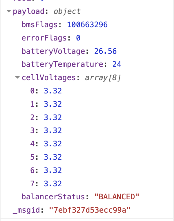

Superb! Allready fixed, :heart_eyes: I can confirm, that now the Values seem to be correct:
I will check when the battery is charged up further to 3.55V as per now it is “in the flat part of the LiFePo Charging curve” and all the cells show the same value (3.32V). If I find any difference to what VictronConnect is showing, I will report back here.
When I tried the node yesterday, clicking on the magnifying glass revealed no found BLE Devices. (Perhaps I was to impatient and should have waited longer after the installation and restart of node-red?) Anyway i entered via Copy & Paste into the “Device”-Filed directly from VictronConnect which was a string in this form: “dead7cf3beef” missing all the colons normally seen on hex mac-adresses. But now it shows up fine all the BLE-devices close to the Ekrano, so basicaly no need anymore to enter the mac address manually.

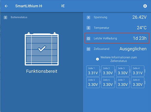

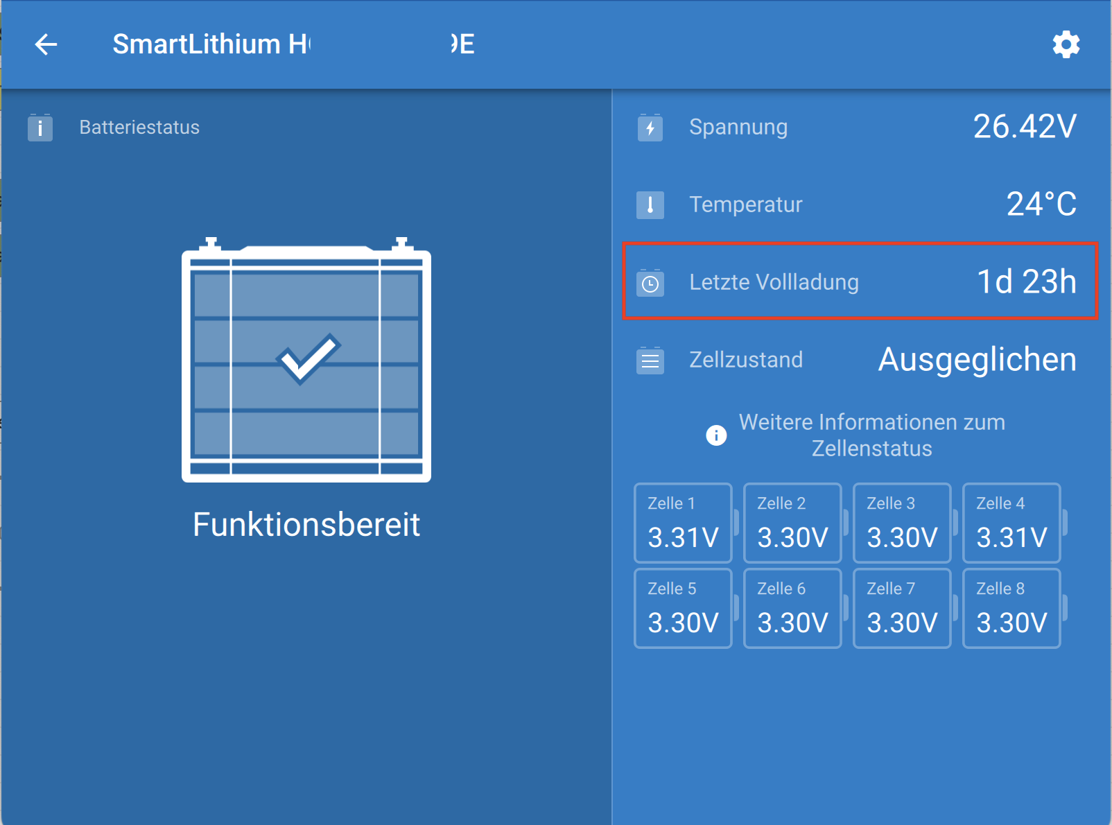

While playing a bit more with the BLE Node and comparing the Data I get from VictronConnect I noticed, that in VictronConnect on the SmartLithium Batteries they show the time since the battery was last fully charged:
Is it possible to have this information (it might also be just a Unix-Timestamp when last charged or a number like “minutes since last charged”) also available through your BLE-Node?
It’s not really important but would be nice to have if implementation is not too complicated.

RE: letze “Volladung”. I assume this information is not accessible via the Instant Readout, as shown in the picture:
. Therefore, it also cannot be used. Victron has only published instructions on how to parse and read the values for that Instant Readout feature. All information available in the details and detailed readings is not accessible to the public.
OK, thanks for the mention! :+1:

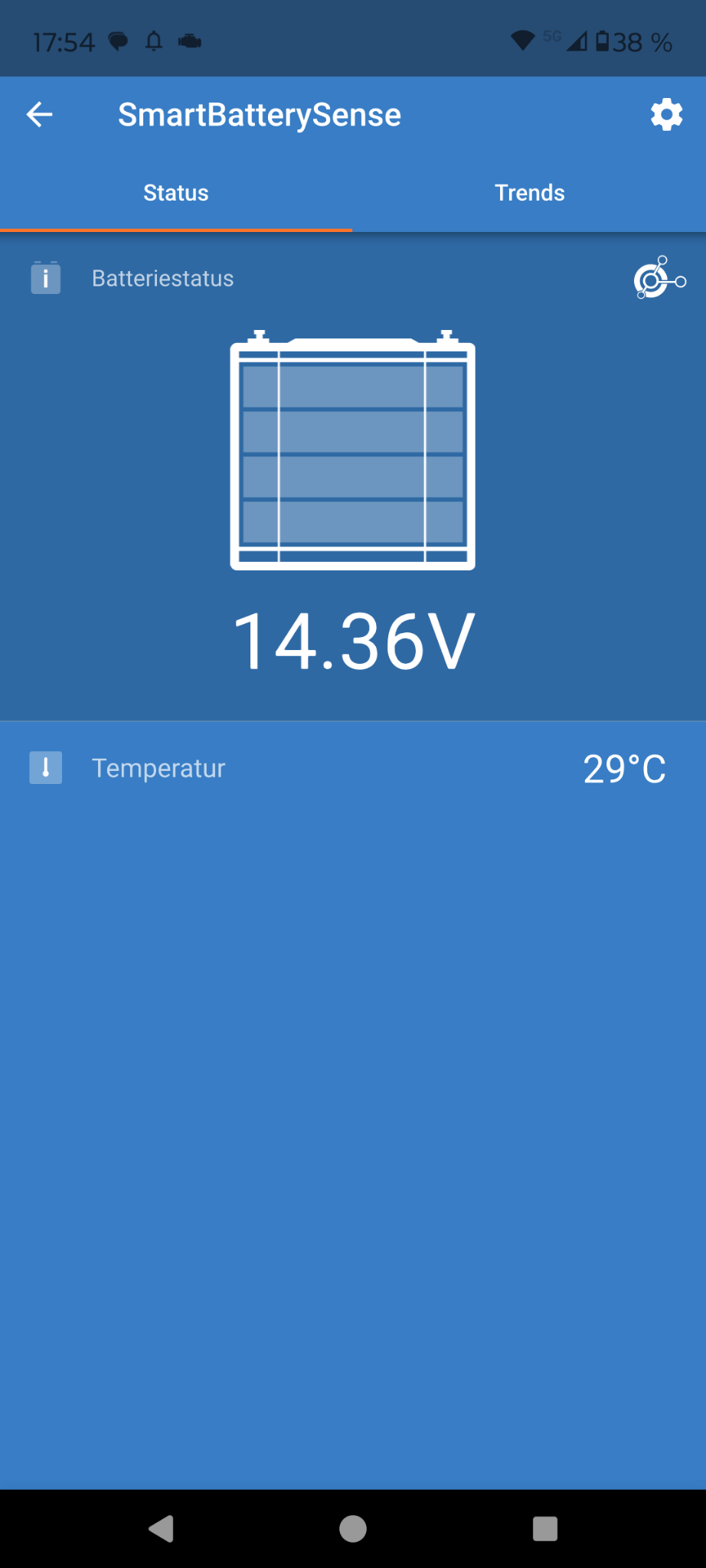

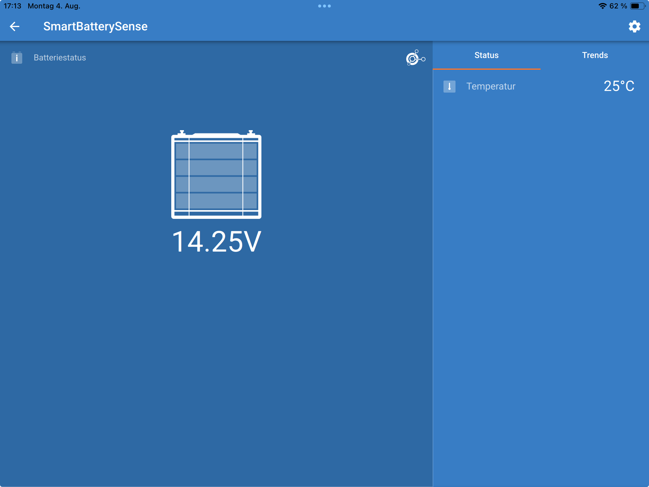

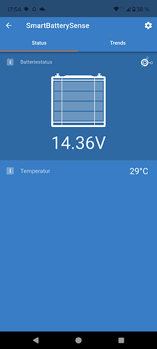

With Smart Battery Sense, the values don’t seem to be right at first glance. It also can’t measure current, only voltage and temperature
@DirkW please test the new Version 1.2.3 that I just published
Ok :wink:
Thank you for your work

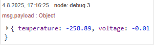

Smart Battery Sense should be 13,48V and 19 degree Celsius
3.8.2025, 23:11:27node: debug 3
msg.payload : Object
object
temperature: -259.64
voltage: -0.01
@DirkW sorry I can not really work with your message.
If it still does not work, please sent a screenshot of the version of the node-red-contrib-victron-ble node in the palette manager and a screenshot of the payload,…

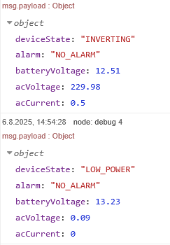

Phoenix Inverter with Smart Dongle works :wink:
