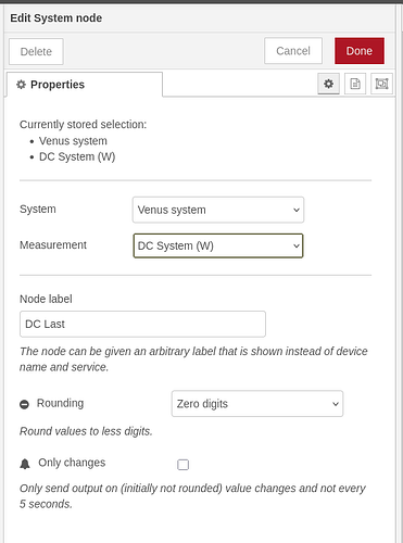

If you mean the Victron Smart Shunt, my one is available at
SystemNode->VenusSystem-> DCSystem-(Watt)
Thanks for the reply, I’m talking about Smart Battery Sense which unfortunately is not managed individually but as an element serving the MPPT to know the voltage and temperature of the batteries being charged
