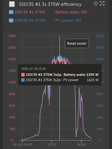

Potentially the difference between the pv power and whats actually being sent to the battery (battery watts), i.e The system losses in the 450/200 conversion. You can create a custom vrm chart tracking pv power and battery watts to determining if that’s what you are seeing.
The rs450/100 and 200 have significantly more loss than a 250/100 or 150/35 for example, as per the spec sheet:
