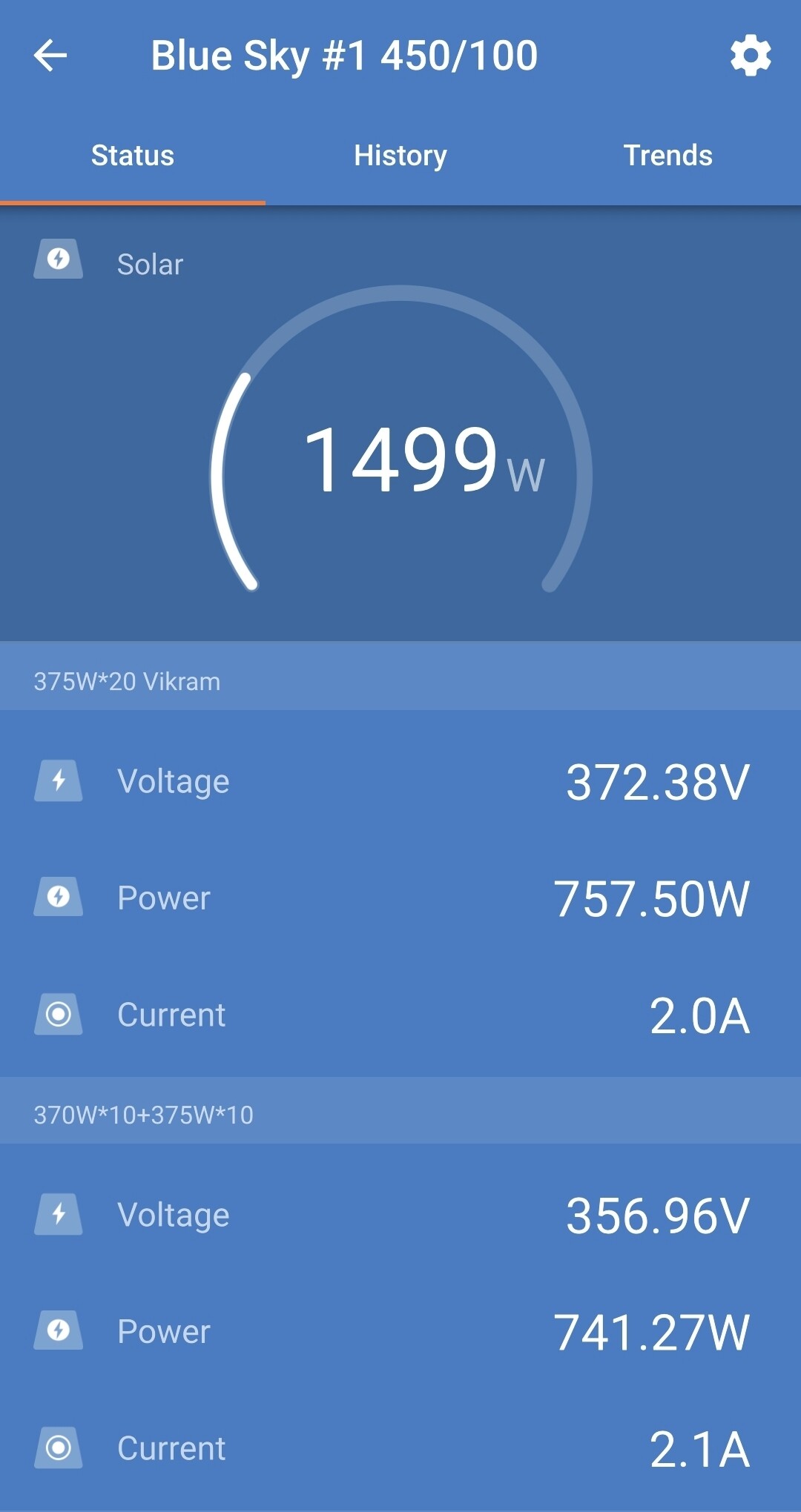

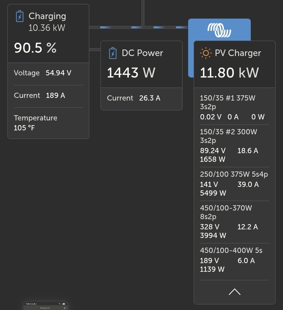

I run both. I started with the 450/100 then added the 250/100 later.
Its best to think of the 450/100 as two 450/50s due to the per tracker 4kW limits. And then the 450/200 it can be around three 450/70s, versus 4 450/50s.

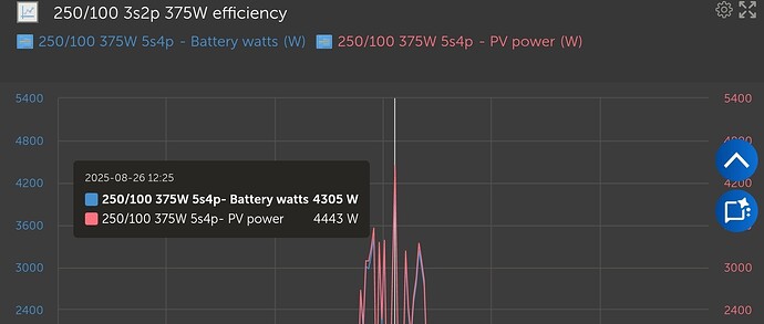

The main thing with the 250/100 is that obviously youll need multiple parallel strings to max it out. I use staubli branch connectors and inline mc4 fuses for 5s4p, it can approach 40A so wire appropriately:

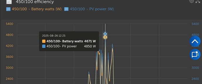

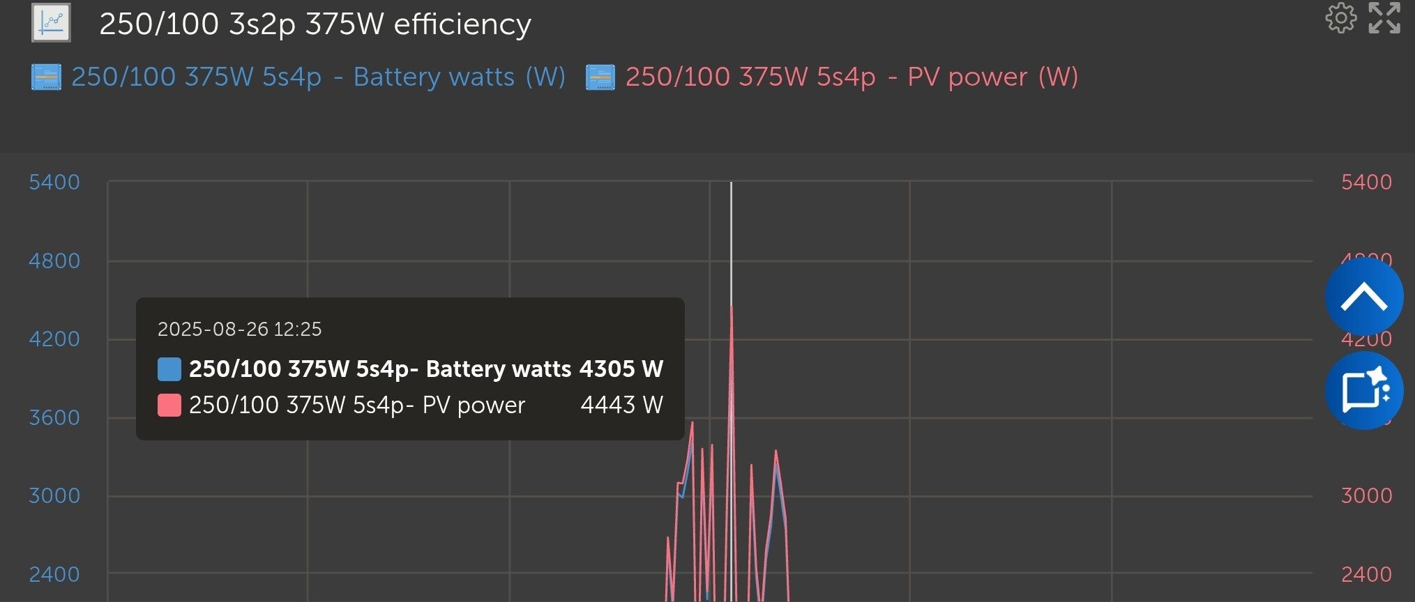

Other advantage of the 250/100, bit more efficient, the 450 is wasting more at the top end:

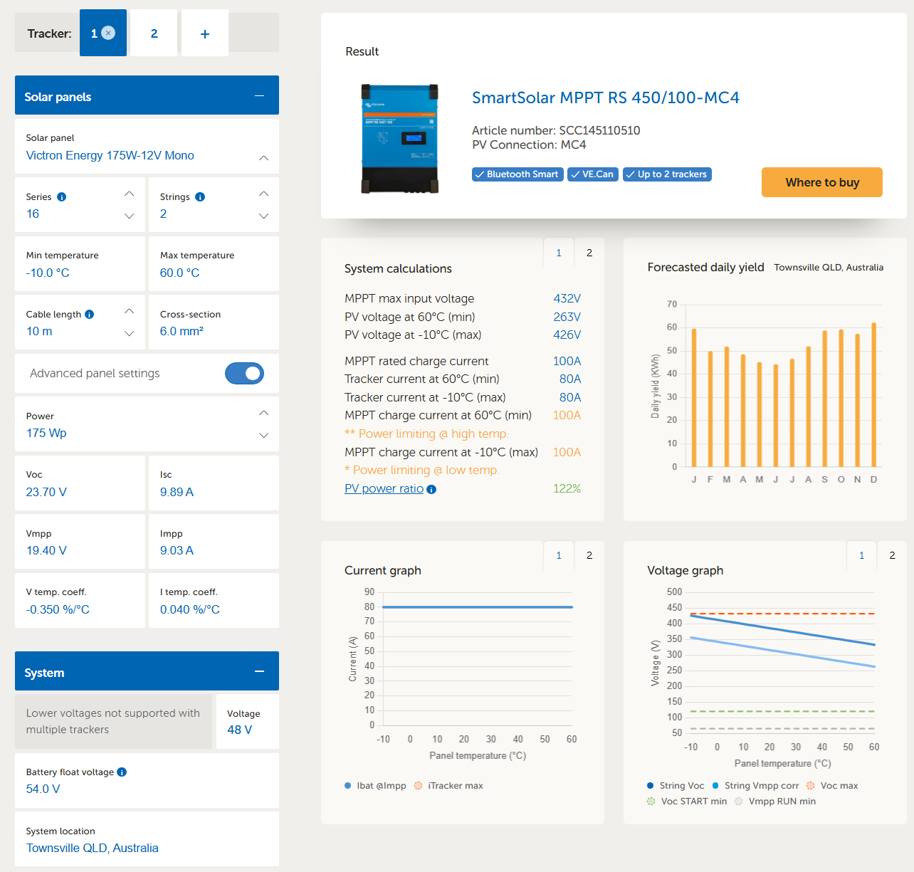

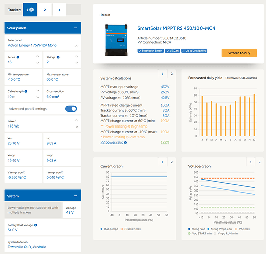

In January this year with very overcast conditions I connected 10s2p to each of the two trackers on my 450/100 for 15kWp. Worked fine. But with that amount of ovepanelling when the sun comes out from behind the clouds the 450/100 really ramps up its fans to a maximum I wasn’t aware of during non overpanelled edge effect conditions. So to capture that intermittent sunshine I added sufficient scc capacity to cover that, and avoid excessive fan noise.
Thats good information. I can only add 7 in series with the calculator for 80A per a tracker.
The 450/100 is best for east west facing arrays if you want to do a massive north facing one then you will need the 450/200.
It would be good if they could update the calculator to let it go to 20A per a tracker.
Update, I just put 32 175W panels on there thats 5600W peak with 18A per a tracker.
Thats actually quite clever. So the issue is mostly in my mind.
