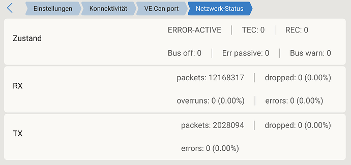

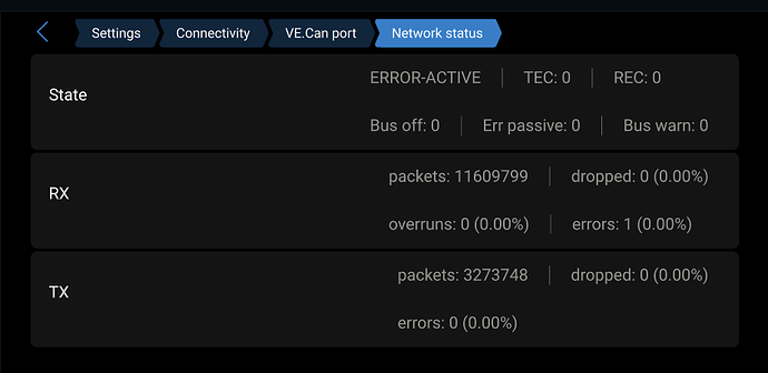

Here are the CAN bus statistics from my battery; there’s no apparent error
Similar result, thanks!
