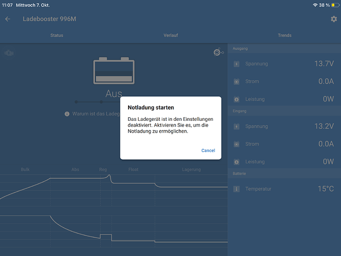

I’m now using the charging booster as a workaround to charge an AGM battery (not the starter battery) from a lithium battery. So I wanted to try reverse charging and enabled the booster and alternator detection. The system is now telling me that emergency charging can’t take place because the booster isn’t enabled. I don’t understand that.

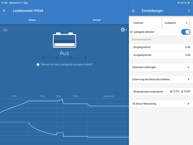

Why don’t you show us your settings?
I could imagine it being due to the 0.5 A current.
I just tried it at 5.0 amps. Same result.
The screenshots show that it would already load in bulk, which mustn’t happen either.
What does it show in the overview as well, where the current values are displayed?

According to your screenshot, the booster is currently charging the LiFePO. That normally only happens when the engine is running and the input voltage is high enough. The booster sees that too, so it naturally disables the emergency charging function.
Try setting the engine-running detection voltage higher, so that it’s above the AGM voltage. Otherwise, the booster will always assume the engine is running.
Oh, damn, I had the batteries the wrong way round. Of course, the AGM is the “starter battery” and is charging the LiFePO, because its (too high) voltage triggers the engine-on detection. I’ve corrected it above.

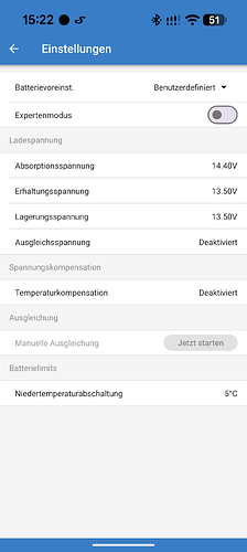

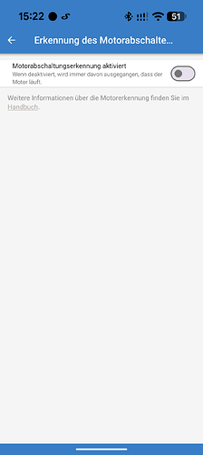

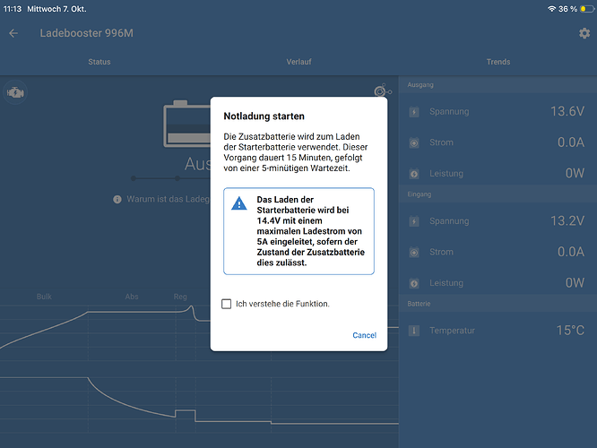

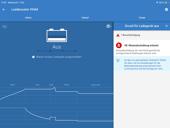

Hello, and thank you very much for your message,
Unfortunately, emergency charging still won’t start. Please see the attached screenshots. The engine does need to be switched off for emergency charging to begin, doesn’t it? I’m still at a loss.

Hello everyone,
and just now it worked. I think it must have something to do with the 120-second delay that’s set by default, so that the starter battery isn’t loaded straight away when the engine starts. This parameter also seems to apply to emergency charging, which makes no sense.

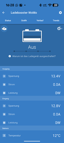

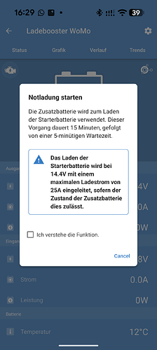

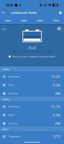

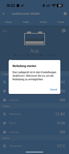

Regarding emergency charging of the starter battery.
My Orion XS 12/50 is switched on and off via the D+ signal. It all works very reliably.
When the engine isn’t running, the DC-DC charger is switched off. However, that’s exactly the message I get from the app when I try to activate the emergency charging function. The charger is, of course, enabled in the settings.
If I need to use the emergency charging function because the starter battery doesn’t have enough voltage to start the engine, I can’t start the function because there’s no D+ signal.
Can I install a jumper wire with a toggle switch between the H and L terminals to start the charger manually? In addition to the D+ signal cable, that is. Or could something get damaged if D+ is applied to both H and L via a bridged connection?
Surely the programmers can’t have intended me to first enable “Engine shutdown detection”, thereby changing my setup, just to make emergency charging work.
I don’t know whether this has already been mentioned in this thread, but I’ve definitely written it a few times before:
The remote signal is NOT required for emergency charging; that was changed in the beta already.
If the message still appears, it’s caused by something else.
Could you please take a few screenshots of the overview page showing the current values, and of the settings?
It would be useful to have the screenshot with the “error message” in English, so I can forward it to the developers if necessary.

“Engine shutdown detection” must be enabled so the Orion knows whether the engine is running. However, the switch-on signal via H and/or L that you use for your D+ control isn’t needed for this.
Another criterion for emergency charging is the starter battery voltage dropping below the “input voltage lock-out”. This is also supposed to work without enabling “engine shutdown detection”, but I haven’t tested it.

The D+ signal (or a bridged remote connector) is NOT needed!
In your case, the low “input voltage lock-out” will prevent emergency charging.
If motor shutdown detection is disabled, the starter battery voltage must be below the input voltage lock-out threshold, which in your case is 11.5 V.
For most people, the problem is simply that the error message is misleading.
If it said “motor shutdown detection” instead of “charger”, everyone would know straight away.
