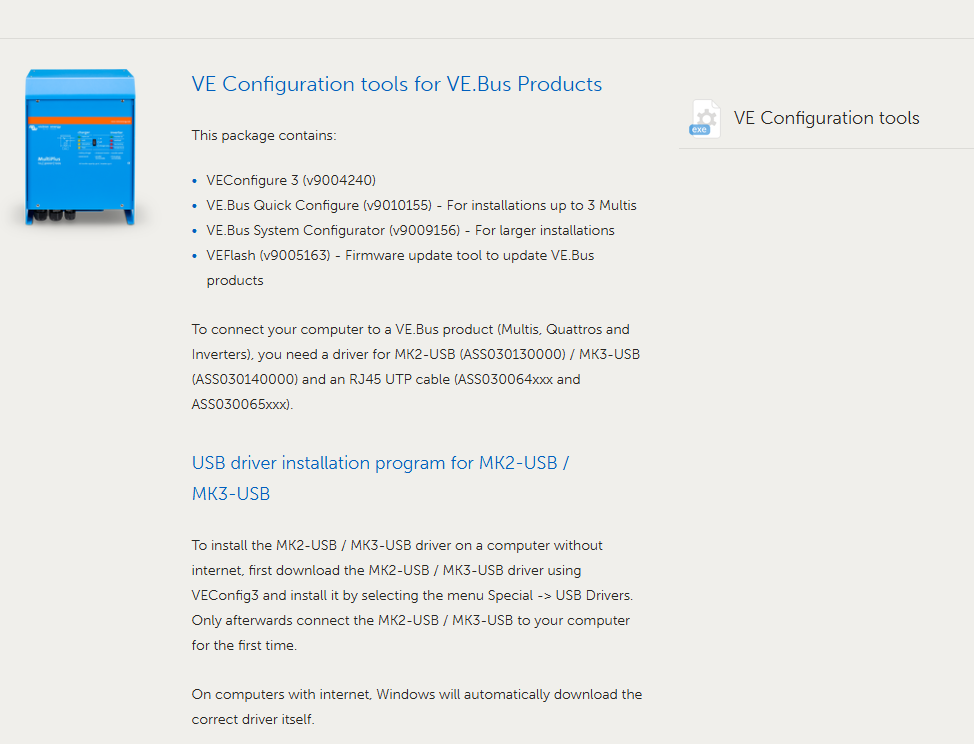

you need to use the VE Configuration tools for VE.Bus Products software not Victron connect
Ok, I used the VE configuration tools, installed the driver, and was able to update the settings.
I still cannot see the Multiplus on bluetooth, but it worked from my PC

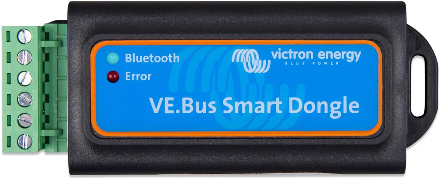

The MultiPlus doesn’t have Bluetooth.
for Bluetooth you will need this adaptor
