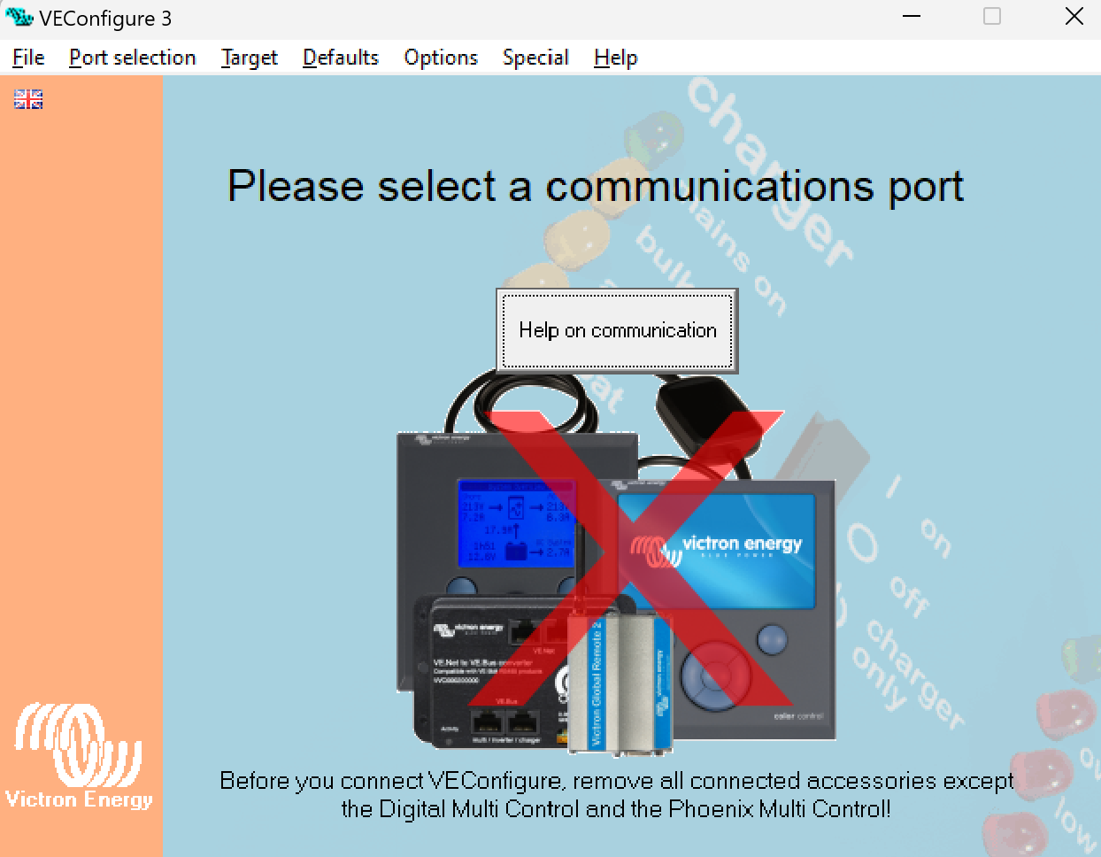

When starting VE Configure 3 and plugging in the MultiPlus II (independant if the MultiPlus II or the MultiPlus II GX is plugged - important is the OR!), I first try
‘Port selection - Com Port - Auto detect’
It takes a while displaying dots and then I get this view:
Same result if I don’t select ‘auto detection’ but directly ‘Com 3 (USB serial port)’
