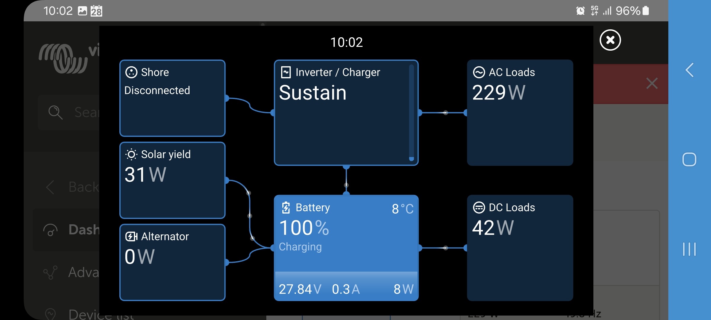

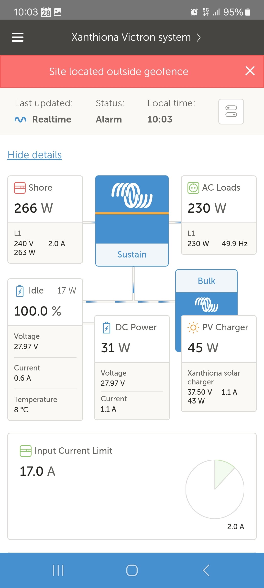

The shore power shows disconnected on the GUI app on a stand alone Samsung S9 and on Remote console on the Victron Connect app on a Samsung S21, but it is not disconnected as shown on the Dashboard of the Victron Connect app.
What firmware version av you running of Venus OS? There was a bug in GUI v2 that made the shore power/grid show as disconnected if the Quattro/Multi was OFF (if I recall it correctly). That specific reported case should have been fixed in 3.52 according to release notes.
Running Venus OS 3.52 and GUI version beta4

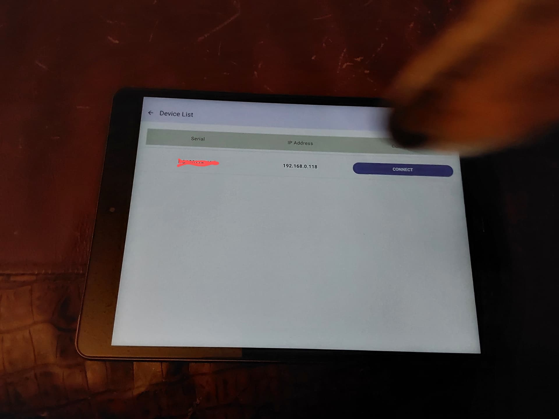

I first tried the APK on my Lenovo M7 TB-7305F and it worked quite OK. After a while when letting the screen go black when i double tap the screen to wake it I arrive at a black screen. Sometimes white. The only thing shown is the battery charge status in the upper right corner.
I then installed the app via the bootloader. The same issue.
I have tried 5s push i the bottom left → search for devices and reconnected. This sometimes helps but most often not. Reload Web doesn’t help either. Reboot gets me back again.
If feels like some kind of restart of the app button would be nice to have.
Often when I wake the screen I get a couple of errors under the Victron logo, and then it reconnects. This is probably due to this being a slow old pad, I can hardly see these om my phone.
Could these problems be due to me having the remote console open on several computers, are these sessions kicking each other out or can one have several parallell sessions?
v1.00beta4, Venus os 3.52. Android Go.
edit: I see someone else has the same problem with this device.
editedit: Is there something I can do to debug this issue?

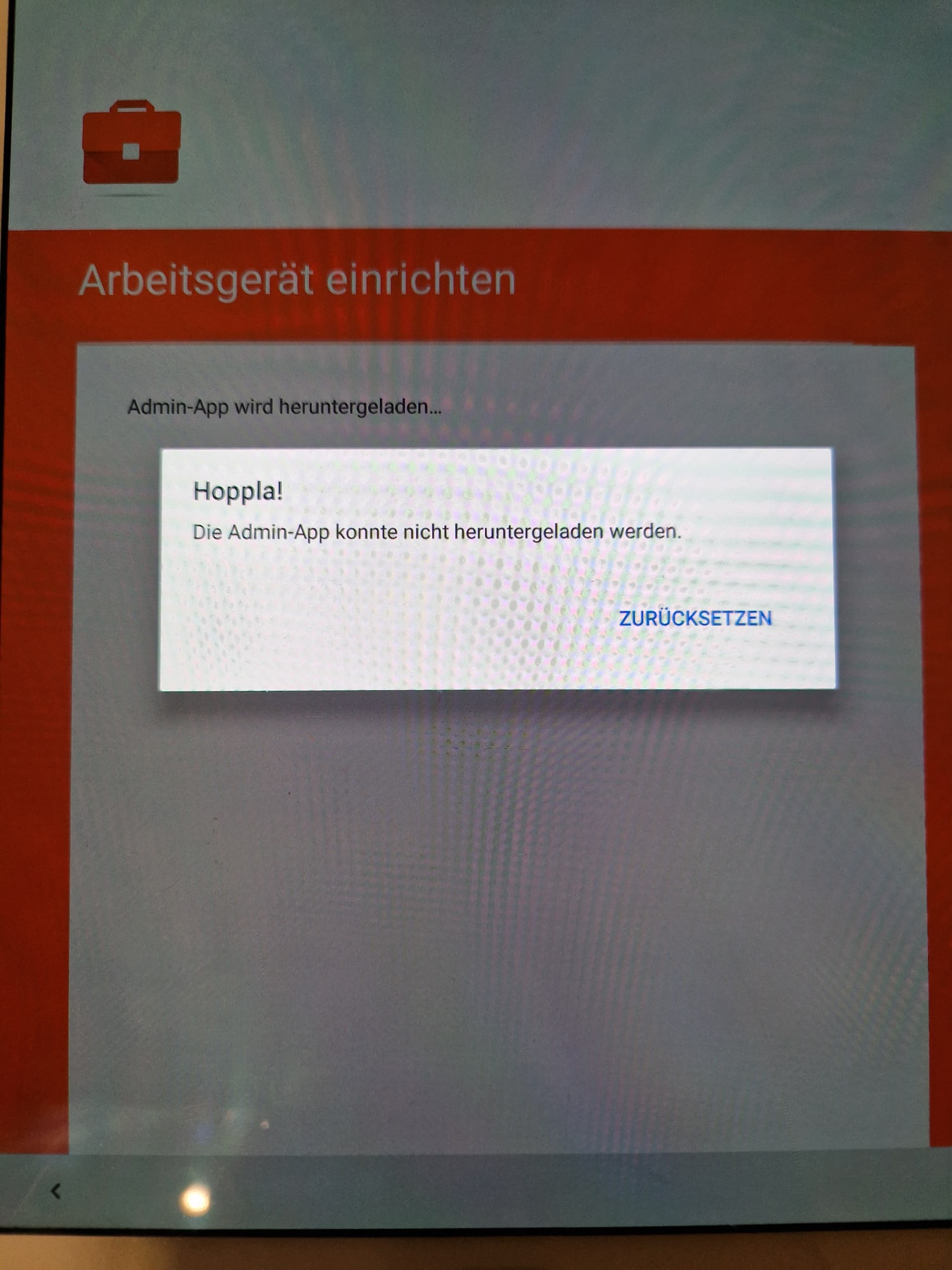

Unfortunately the installation doesn’t work for me. Samsung Galaxy Tab S2 Android 7.
Reset to factory settings.
6x Tap at the welcome screen
Tablet asks for WLAN to download the qr reader.
Tablet downloads the qr reader and open it.
Scanning the qr code leeds to the error message below. (“The admin app could not be downloaded”)
based on that error message, you should double-check the Link given above from a browser. Maybe the file is gone…if the link is working, retry the method or either download it manually and install it from download yourself.
The link works and I got an apk file.
But as far as I understand, installing the apk is not the same as installing via QR code. It is not kiosk mode.
@jperez can you check why I get the error message, please?
I tried with a second Android 7 device (Galaxy A3 Phone) today and got the same message.
you can install the apk manually and try out the App.
If that works, you can make the GXDisplay-App the “launcher”, replacing the standard launcher of that Android device … after a restart, it will launch the GXDisplay App only.

We can’t reproduce this issue. It might be related to the network. Have you tried connecting these devices to a different Wi-Fi network? Alternatively, you could try creating a Wi-Fi hotspot with your phone.
Once the app is installed, you can switch back to the correct Wi-Fi network.
Manually installing the APK has the disadvantage that the app cannot disable Android notifications and other annoyances. However, as long as you’re aware of this, it shouldn’t be a problem.
This might be related to the GPU or its drivers not being compatible due to a bug or lack of capabilities to run the GUI.
Can you reset the tablet, install firefo, try to access the GX remote console v2 and let us know if it does work or not?
Also check if there is any Android update available for that table.
