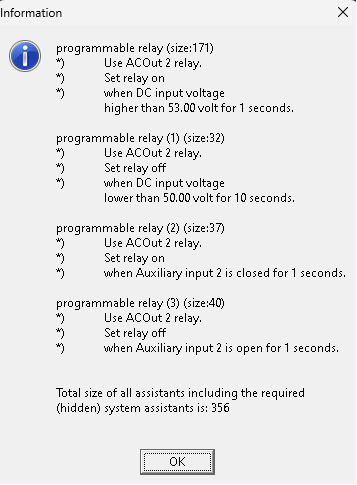

I have 4 assistants controlling ACOUT2.
2 assistants to turn ACOUT2 ON and OFF on Voltage levels
2 assistants to turn ACOUT2 ON and OFF from the switch Venus display page.
If I have the four assistants installed the 2 assistants controlling ACOUT2 by voltage do not work.
Does anyone know why theVoltage assistants will not work?
Thanks
If any of the on conditions are met it will remain on, as on is prioritised over off.
The way your assistants are currently set up, they are OR.
If you need one to be true.
If you want both to be true to be either on or off, then combine them in one assistant to make it AND logic.
As a further point they are difficult to get right as the logic os very simple.

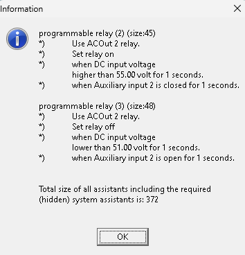

OK Thank you for the explanation.
I will try your suggestion.
I was thinking about the AND and OR function.
Am I able to create an AND function for the two functions, with the Victron Logic?
If you have an explanation that would be great.
I am used to PLC programming, and yes it does appear that there is not a lot of options I have in Victron.
Possibly Node RED may solve the problem.
Thanks again for the information
Yeah it is easier when there are a few conditions that need to be met
Yes
Bluey
8 July 2025 05:44
5
I will try this assistant out and see if I get both assistants to work seperatly.
