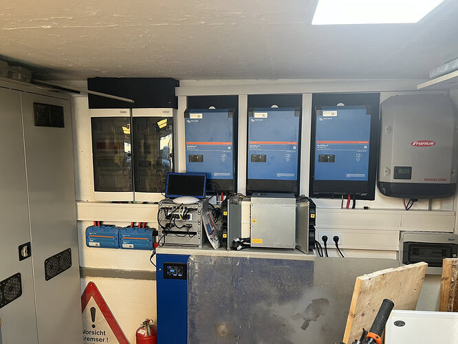

I have set up a three-phase system with 3x MultiPlus 5000 units.
Unfortunately, I keep having the problem that a Low Voltage alarm is sporadically displayed.
About once or twice a month, at different times and with different loads. For example, this error once occurred at 2 a.m., when hardly any electricity was being consumed.
Similar to what happened to Andi from Offgrid Garage:
My setup:
1x Raspberry Pi 4 with Venus OS v3.80-39
7x LiFe batteries with a total of 2715 Ah — 4 of them are Seplos batteries with 320 Ah each (connected via CAN)
1x Victron Power In
1x Victron Distributor
1x Fronius Symo 5k, controlled via Modbus TCP.
Epever plugin by mr-manuel from GitHub
EV Charger plugin by mr-manuel from GitHub
A few other “small” controls via Node-RED, but not involving the DC voltage.
In addition, I switch off the AC-in relays of the MultiPlus via a relay (generator function). This allows me to operate in island mode above a certain SOC value.
The MPs are connected with 75 mm² cables, with all six cables being the same length.
1x SmartShunt via USB — VE.Direct

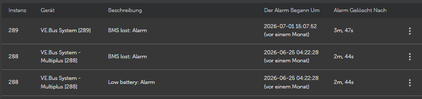

At 15:154 today, it happened again:
However, the VRM Portal has not reported any error or alarm since 1 July 2026.

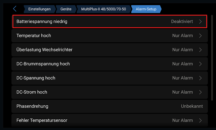

hello,
i just disabled it because it isn’t triggered only by undervoltage!
bye
What did you disable?

the low-battery warning
Hello
@d_ferdi do you mean this?
I’ve already tried that, unfortunately without success.

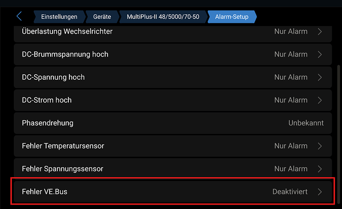

I disabled this today to test it, because I noticed that when I unplugged the MK3 USB cable and then plugged it back into a USB 3.0 port, the inverters immediately switched back on.
Could communication via the MK3 interface be causing a problem?

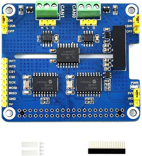

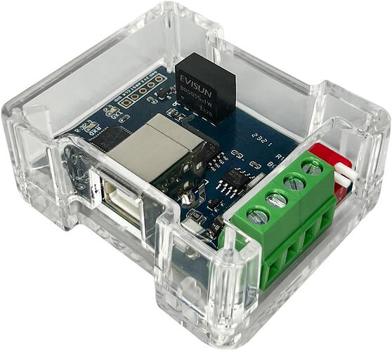

The BMS lost alarm was on 1 July 2026, and that’s when I switched from:
to CAN HAT:
I haven’t had the BMS error since then.

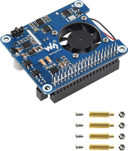

The Pi4 is powered via a PoE HAT:
so that shouldn’t be a problem.

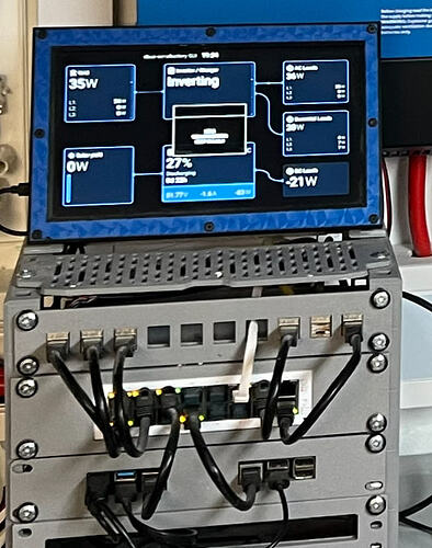

CH341 was a BLE proxy for Home Assistant. I plugged that into the Pi next to it (a Pi in kiosk mode for the display).
