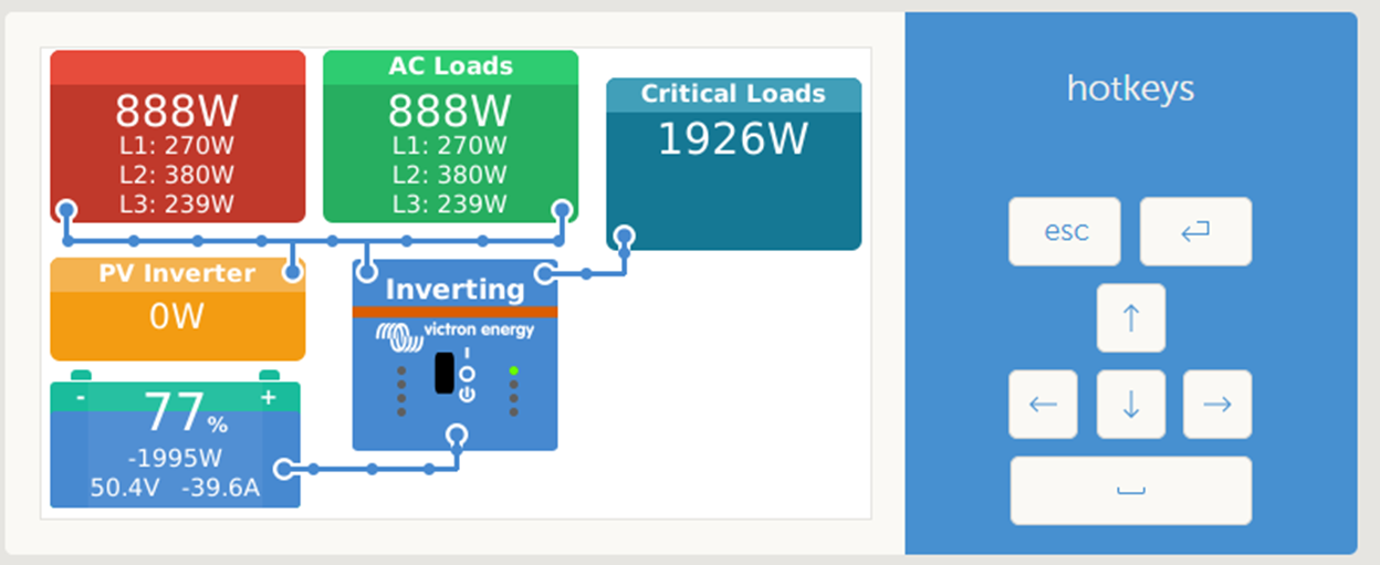

@Angie-Felicity, I have possibly an issue. I have configured the ESS of my Multiplus II 5000 according to the description you have provided further above. But the LEDs (Mains On and Low Battery) keep blinking when discharging the batterie. The Felicity LUX-E-48100LG04 is connected via CAN Bus to my RPI running Venus OS. Please find below some screenshots. Maybe someone has an idea what the problem is ?

Hi, I see that the communication is successful in your screenshot, as for the LED blinking when the battery is discharged, I would need a specific video to determine whether its a fault or not

Hi Angie, I assume the issue is that battery is loaded with 80% which should correspond to a voltage of 53.2 V. When discharging with 20A as shown in the screenshots then the voltage drops to 50,3 V. I believe as the cut off voltage is defined with 48V and inverting is allow again when voltage rises 3.25 V above the cut off voltage then voltage of 50,3 V is below the inverting threshold. Maybe inverting again voltage of 51,25 V as proposed in your document, might be a little bit too defensive setting ?
BTW what would you like to see in the video you have been asking about ?

how was the LED running?

What I did was I disconnected the Multiplus II 5000 from the grid and connected a hair dryer to the no breaks load output of the Multiplus. Then the batterie low LED started to blink.
During this time I did take a screenshot of the cell voltage
Seems as if the cells with even numbers keep the voltage better then the odd ones. Especially Cell 9 seems to drop quicker then all other cells.
Update: Last picture was updated
@Angie-Felicity: Do you consider this as normal ?
hello,according to the EDMS screen,the cell voltage is normal
