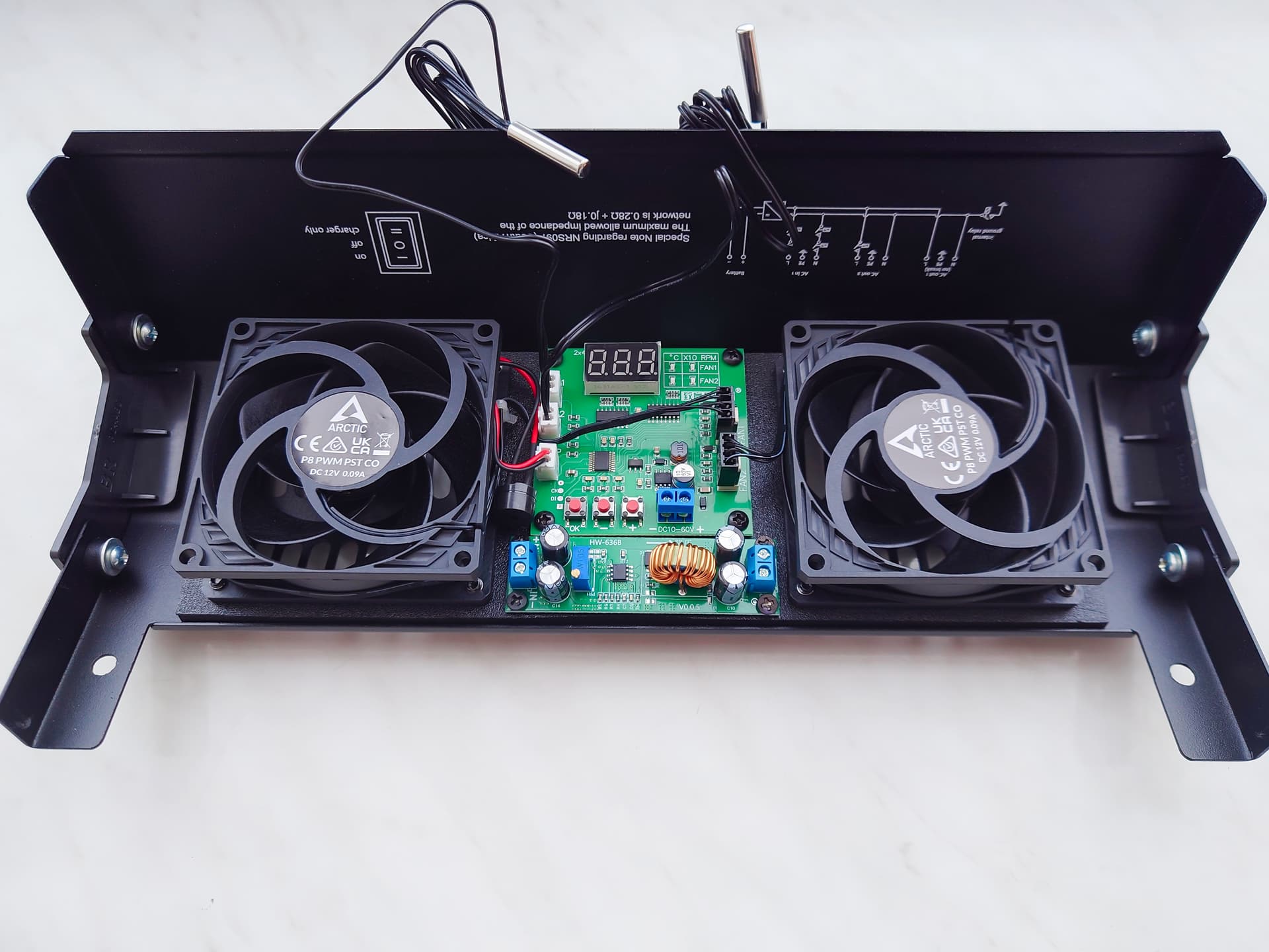

MultiPlus II - modification additional cooling with programmable PWM
Summer is hot, to make life easier for your inverter you can spend 25 Euros and enjoy how the inverter does not reduce its productivity.

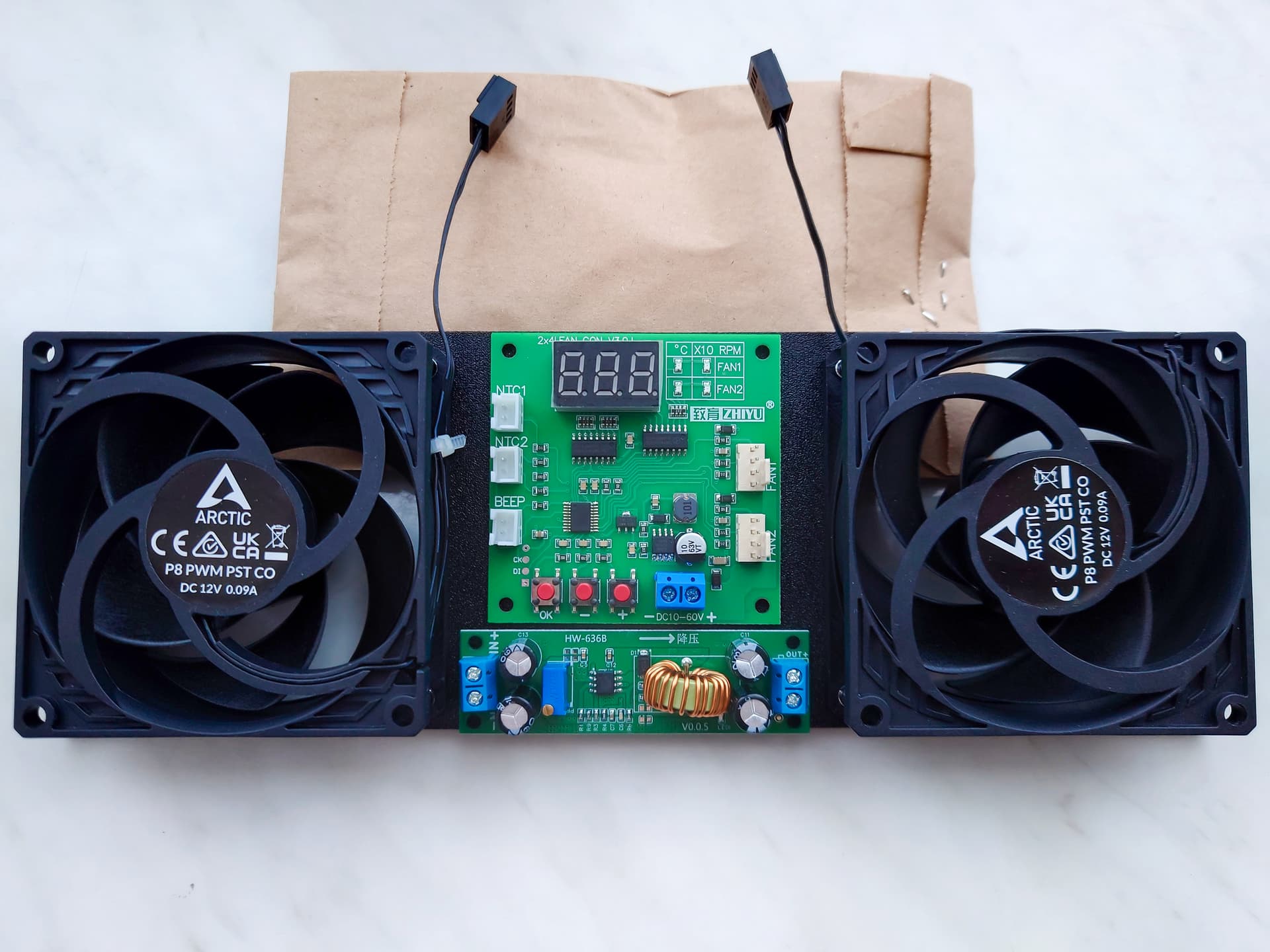

In this assembly uses a step-down converter, programmable PWM controller with 2 temperature sensors and alarm speaker.
My best regards to the Victron Engineers, I’m doing your work for you :wink:

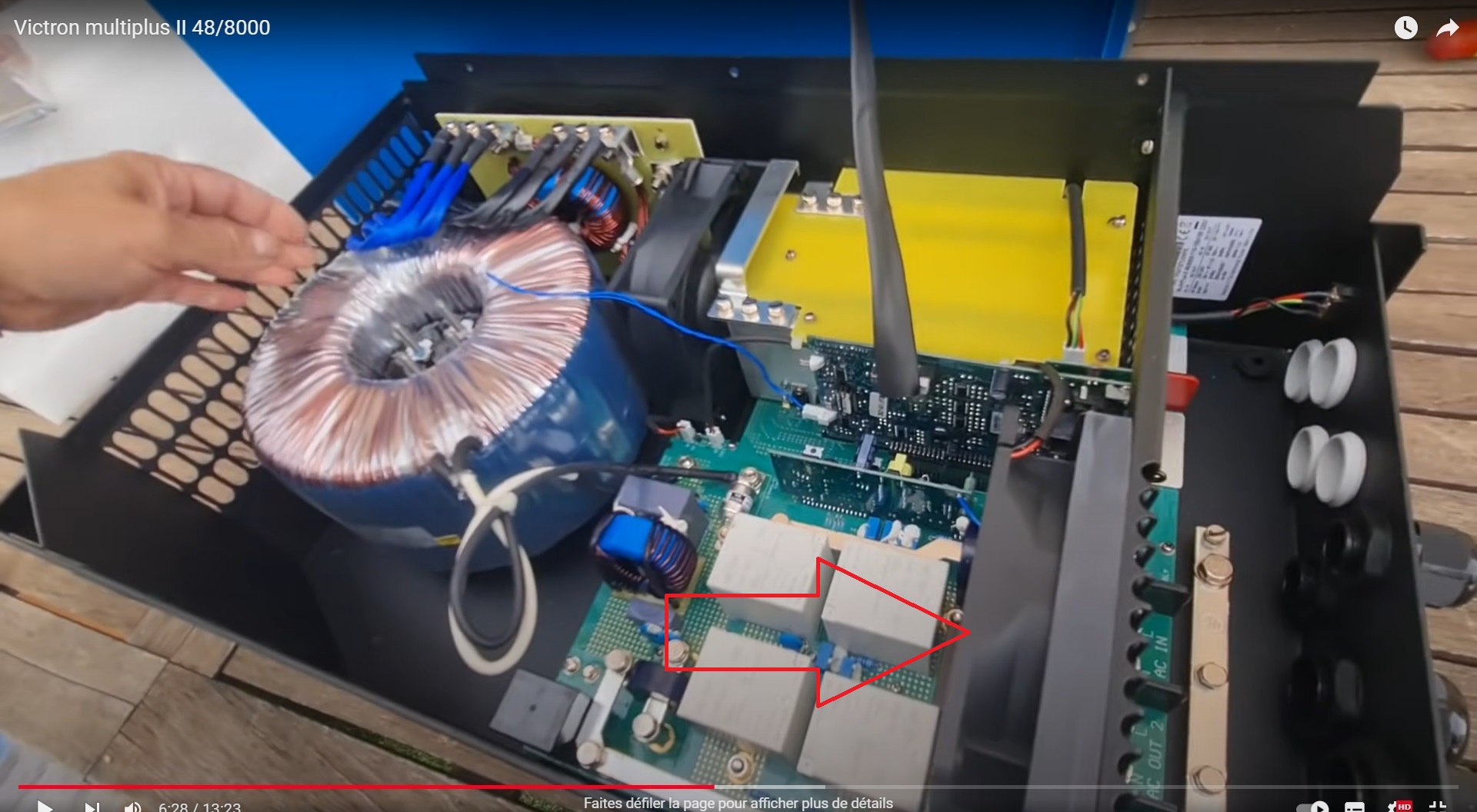

just a small downside on the 8K multi and more because they have a second fan opposite the DC connectors
I know what’s inside each model.
OK, and aren’t you afraid that there might be some sort of airflow interference between two fans that are so close together?
Are you kidding, airflow interference? :joy:
The air flow is too low to be a concern.
If you say so :zipper_mouth_face:
