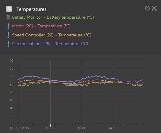

If you want to fit external cooling fans (e.g. to blow cool air in to the MP at the bottom and/or extract hot air from the top) you can use a fan assistant (uses the internal cooling fan state) to switch one of the internal relays – I use the K1 relay to control 2 external 24V fans, one blowing cool air from outside into the electrical cabinet and one sucking hot air out, so these come on every time the internal cooling fans do.
When the weather is hot these come on periodically in the daytime, just due to quiescent power consumption heating everything up – see the sawtooth in “electric cabinet” temperature (sensed using a Ruuvi tag, sitting on the bottom of the cabinet next to the MP/Quattro air inlet)
