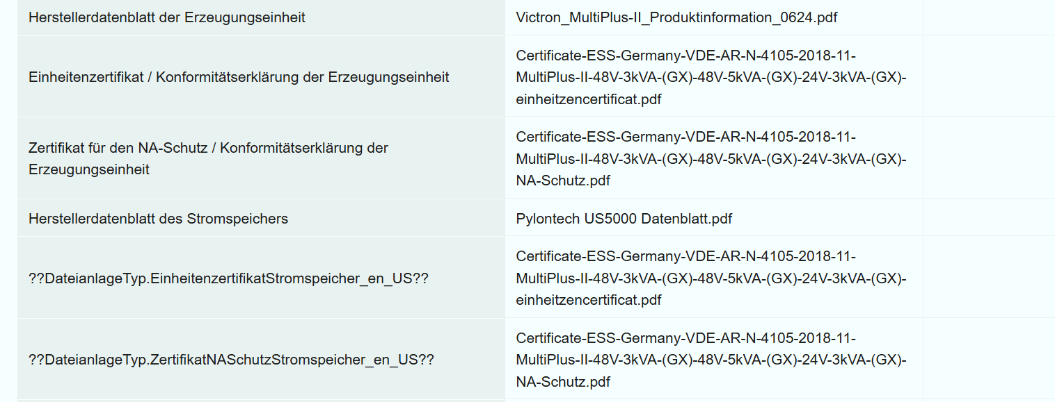

However, the larger Multi units (8000, 10000, 15000) are listed as generators on the certificate, as shown in the screenshot. In my opinion, this distinction doesn’t make sense, since a 5000 has the same functionality and is only limited in terms of power.

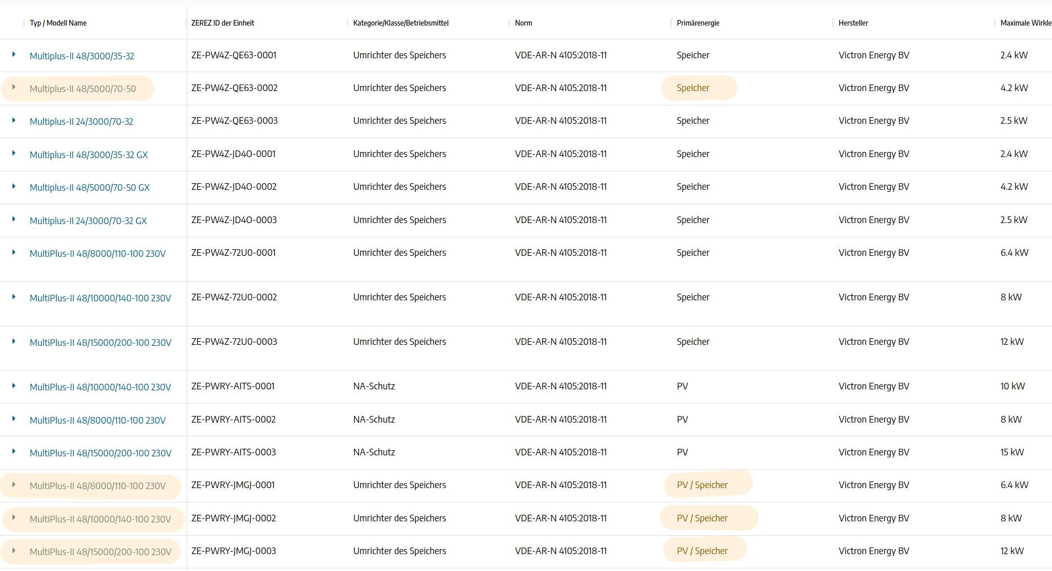

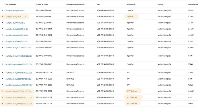

Not quite—the certificates are there, but for the 5000 model only as a storage device (see the screenshot further up). Registering with Stromnetz Hamburg is done entirely online via a form, where you can either enter a ZEREZ ID or search for a device. For example, if you search for MultiPlus under “Generating unit”, the 8000, 10000 and 15000 models are offered—the ones that, according to the screenshot, are also listed as “PV” in the “Primary energy” column of the ZEREZ database.
You can find the 5000 model in the “Battery storage” section of the online form, but that doesn’t help with the registration, as at least one generating unit has to be configured; otherwise, you can’t proceed with the form. If I try to enter the ZEREZ ID of the MP 5000 directly under the generator, I’m told that it isn’t a valid certificate for generating devices. :roll_eyes:
The complete automation of the registration process means that Hamburg follows whatever is stored in the ZEREZ database very strictly. For a device to be selectable for generation, it has to be listed as such in the certificate—and according to the ZEREZ database, the MP 3000 and 5000 unfortunately aren’t.

The difference in the certificates is also obvious according to the database. The 8000 series, which has PV in the relevant column, can be selected in the form. When you search in the form, you get exactly the entries that appear when you filter directly for PV devices on Zerez. Together with the grid operator’s statement that the input form works as described, it’s therefore obvious why the registration isn’t working. That can’t really be argued away and, since the registration process is public, anyone can verify it themselves (including Victron).
So who can do something about it? Certainly not me. Either Victron, by standardising the certificates and categorising the 5000 series in the same way as they did the 8000 series. Or Stromnetz Hamburg, by adapting the form. My hypothesis: While the grid operator doesn’t care whether someone buys a Victron device or gets fed up and switches to another manufacturer, Victron really ought to care. I just want to finally order my system :wink:

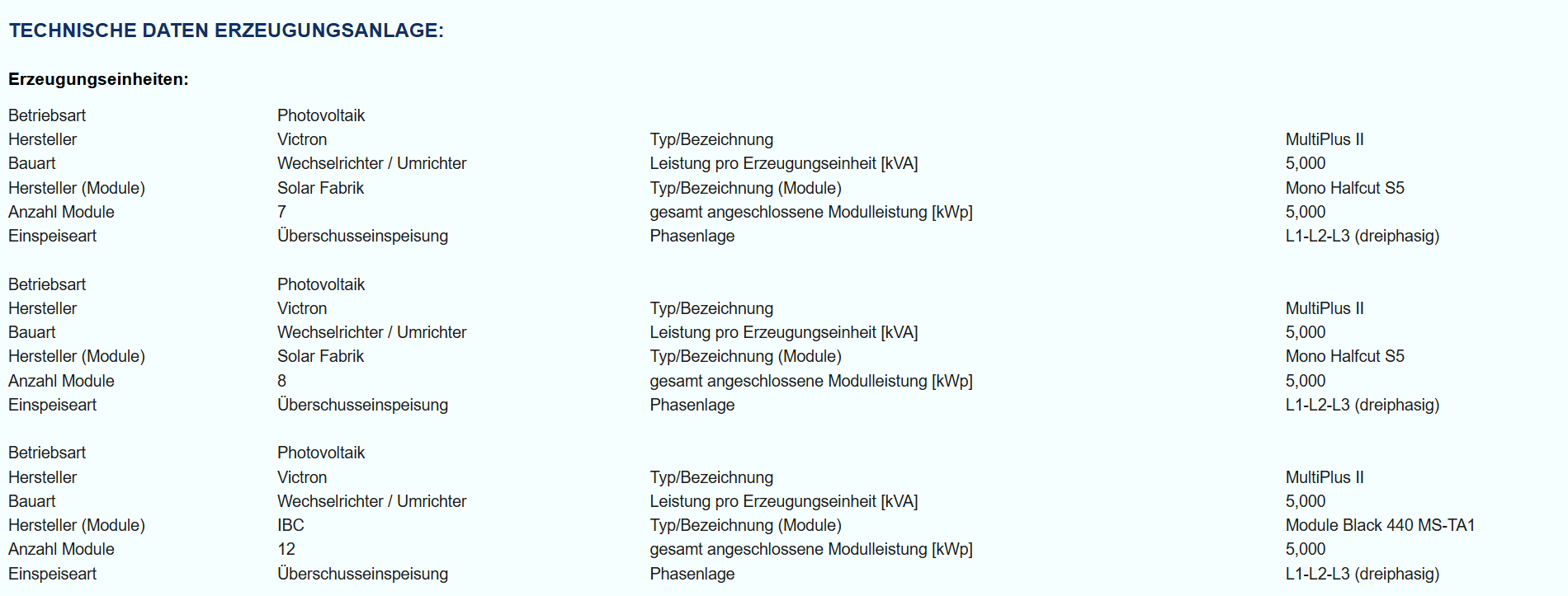

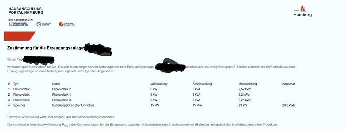

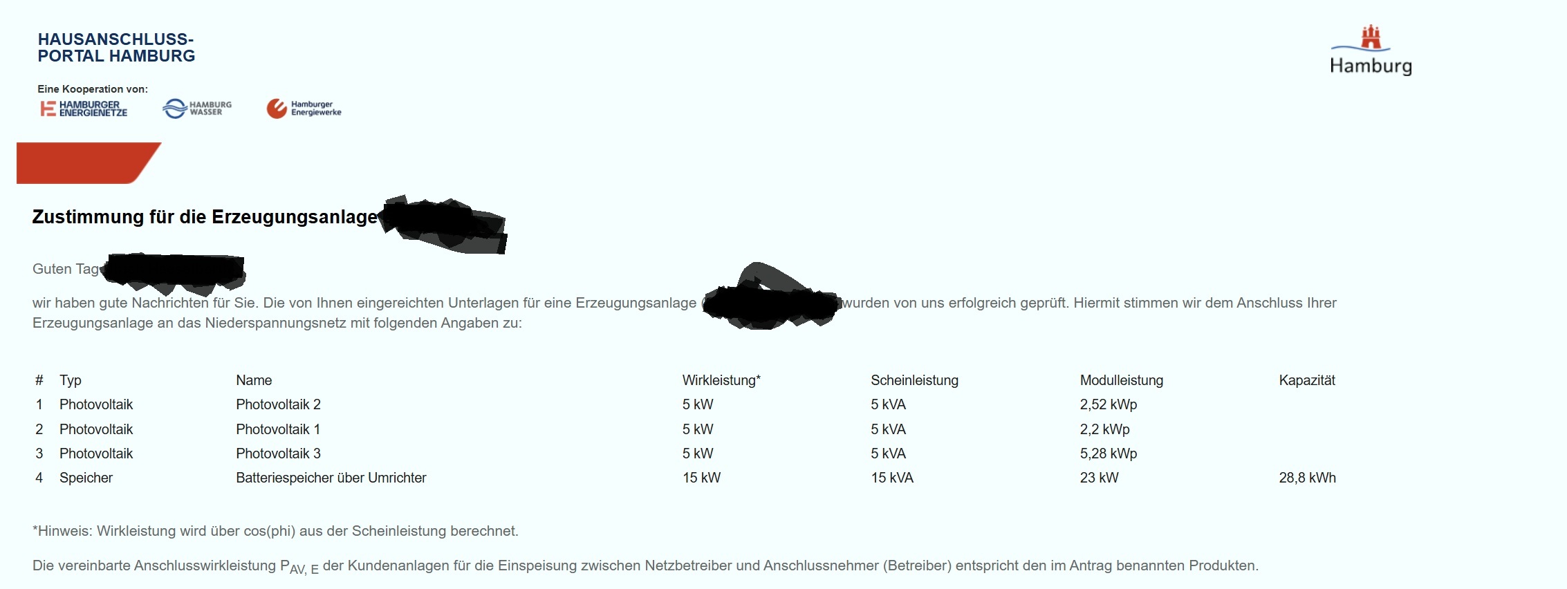

I recently registered, or rather had an electrician register, a system in Hamburg based on 3 Ă— MultiPlus-II 5000 units. It went through without any problems. The application was submitted on 4 March, and on 14 March I received the following information:
Perhaps it does depend on the case officer after all?
Kind regards!
Thanks for the information! Do you happen to know how the electrician submitted the application? You don’t have a case officer through the online portal, which is the problem. The form doesn’t even let you get far enough for a human being to look at it. I can imagine that the electrician has another way of getting in touch. Do you happen to know any more about this?
Best,
Alex
I’d guess an online portal. Here’s what else I found:
Hope that helps :wink:
Best wishes!
Hey, thanks a lot! Now I just need to find a way past the portal :wink:

It’s not the certificates themselves that are the problem, but rather the classification in ZEREZ. There is a tab called “Primary energy”. The 8k, 10k and 15k models are listed there as “PV and storage”, while the smaller MultiPlus units are listed only as “Storage”.
