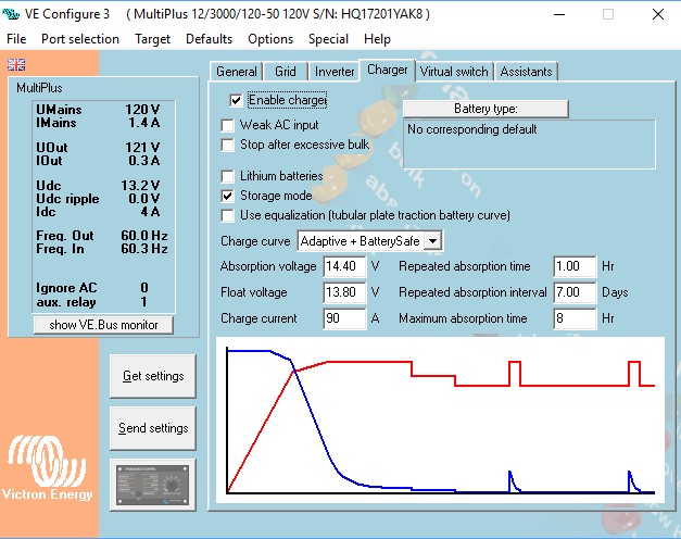

I have a boat with a 500 ah AGM house battery bank. I want to upgrade to LFE 800 ah for less generator time while at anchor. My system has a Centaur 100 and a Multiplus 12/3000/120 but the boat builder says they disable the charge portion of the multiplus and only use the inverter and rely on the Centaur for charging. With my bigger bank design, my c-rate is a bit low and I wanted to use the multiplus to charge the bank along with the Centaur. Any easy way to re-enable the charging function of the multiplus 3000? Just starting out the design and looked into the seemingly overkill for charging capability. Asking the builder he told me they disable it.
The charger settings in the Multiplus have an enable charger box. Hete is a screenshot from the VE Configure program.
