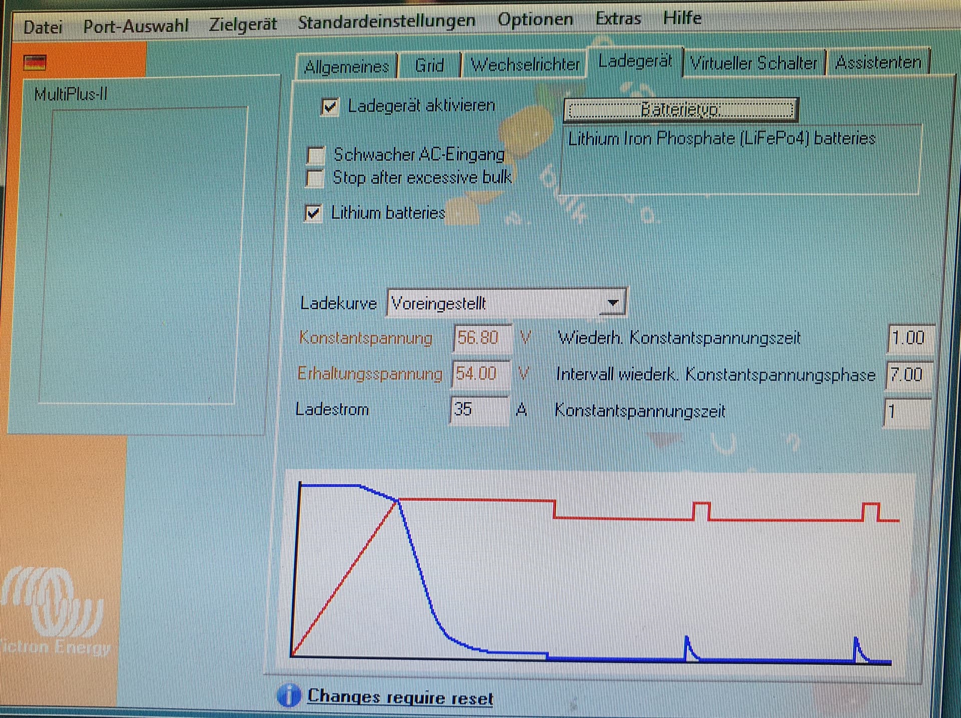

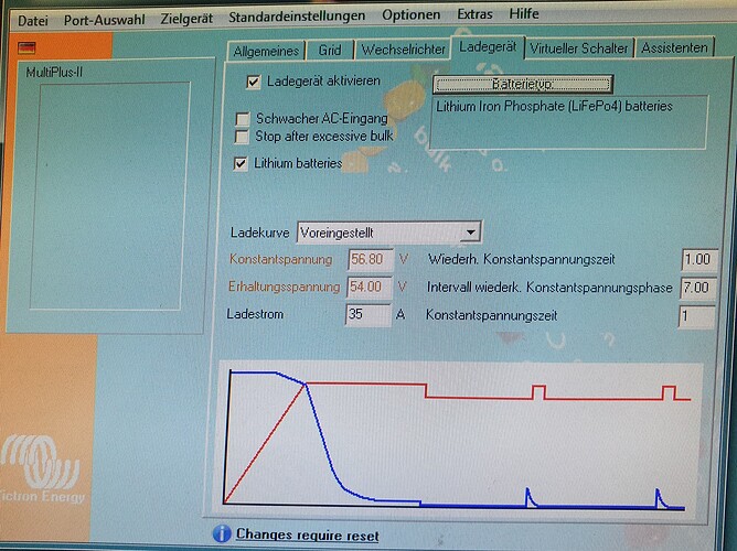

Hey. Thanks for the answers. Are these settings for the LVS 4.0 ok? Thanks for the help. :slight_smile:
