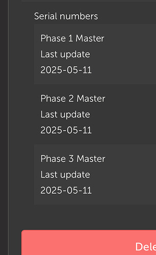

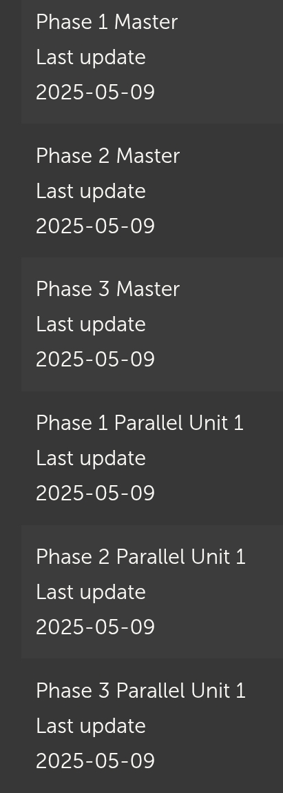

I need your assistance with my Victron system, I’m getting overload L1 I , I was searching for this error and I have been realizing that all my multiplus are master , i was resetting all multiplus to default and select 1 phase and back to 3 phase every change done with send configuration and each multiplus for ess assistant done with this app Ve bus configuration , but still nothing changed, all are still master , what I did wrong?

That’s normal, each phase has a masters (in case you have multiple units on one phase).
Your overload alarm has another cause.
