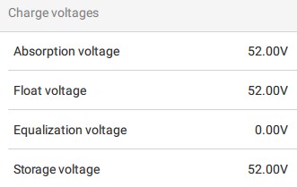

I’ve used the Multi RS with Pylontech as you said, for a period of time, configuring charge voltages as below.
Not always the SOC will be properly computed by Multi RS, but it will work.
The Pylontech need at least 52.2V to charge to 100%, but the 52V is for allowing a small room for high cell voltages on the final stage of charging. Anyway, the Pylontech will throw a high voltage warning only at 3.6V per cell.

Just use 52V and you’ll be fine, because the Pylontechs start to balance from 3.36V per cell.

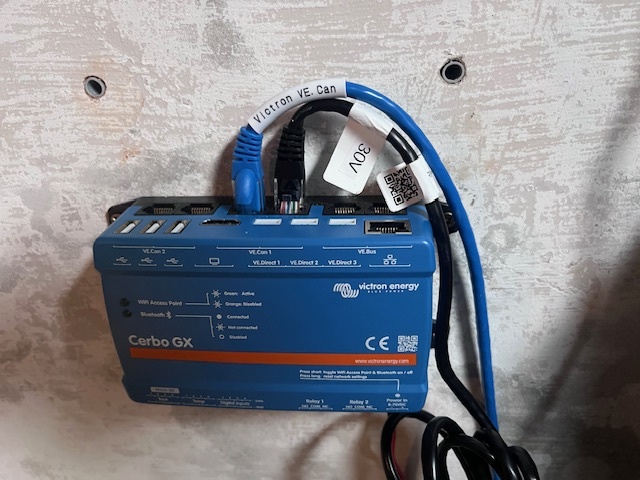

I have received all the components I need for this system, I am now confused on how to wire them together! Please help!!
I have a VE Can to Can bus BMS type A cable between the Cerbo GX VE Can 1 (left) and the Pylontech battery A/Can port, and a 568B cable between the Cerbo GX VE Can 1 (right) and the VE Can port on the Multi RS Solar. The second VE Can port on the Multi RS Solar has a terminator:
Could anyone advise me if this is correct?
Many thanks in advance,
Marco
hi no, you will have to wire them to a separate can port (1 or 2) on the cerbo and set the one with the pylontech connect to bms can and that also needs a terminator, setting is explained in victron pylontech manual
so pylon on ve can 1 (with canbus bms setting) and rs on ve can 2
Thank you Marc
I’ll read through the manuals again…
In your picture you have connected both Multi RS and Pylontech to the same VE.Can port. But they both talk different language and use a different port speed.
You need the Cerbo GX as a translator between your Multi RS and Pylontech so that they can understand each other.
You have two VE.Can ports on the Cerbo GX Mk2.
  1. Connect the Multi RS to one port and terminate both ends.
  2. Connect the BMS cable from the Pylontech to the other port and terminate it. The Pylontech has an internal terminator so you only need to terminate the side on the Cerbo GX Mk2.

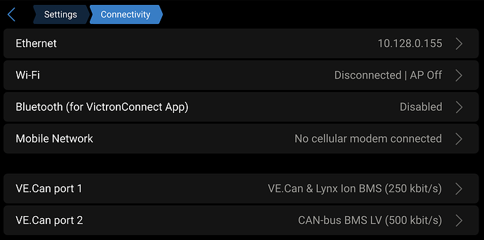

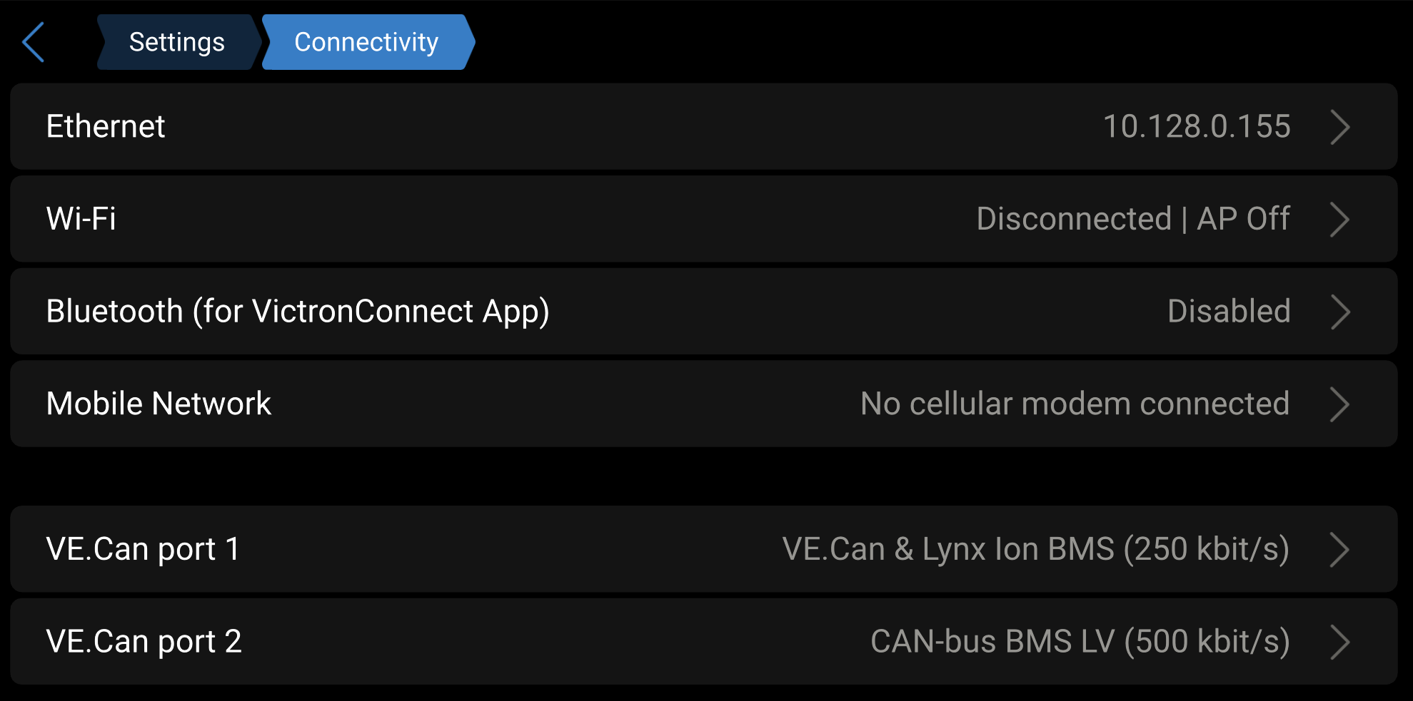

In the Cerbo GX you configure what CAN-bus profile you want.
  1. Configure the port connected to the Multi RS as VE.Can & Lynx ION BMS (250 kbit/s).
  2. Configure the port connected to the Pylontech as CAN-bus BMS LV (500 kbit/s)
When correctly configured you can see the Victron devices on one port.
And you can see packets being sent and received on the port that is connected to the Pylontech.

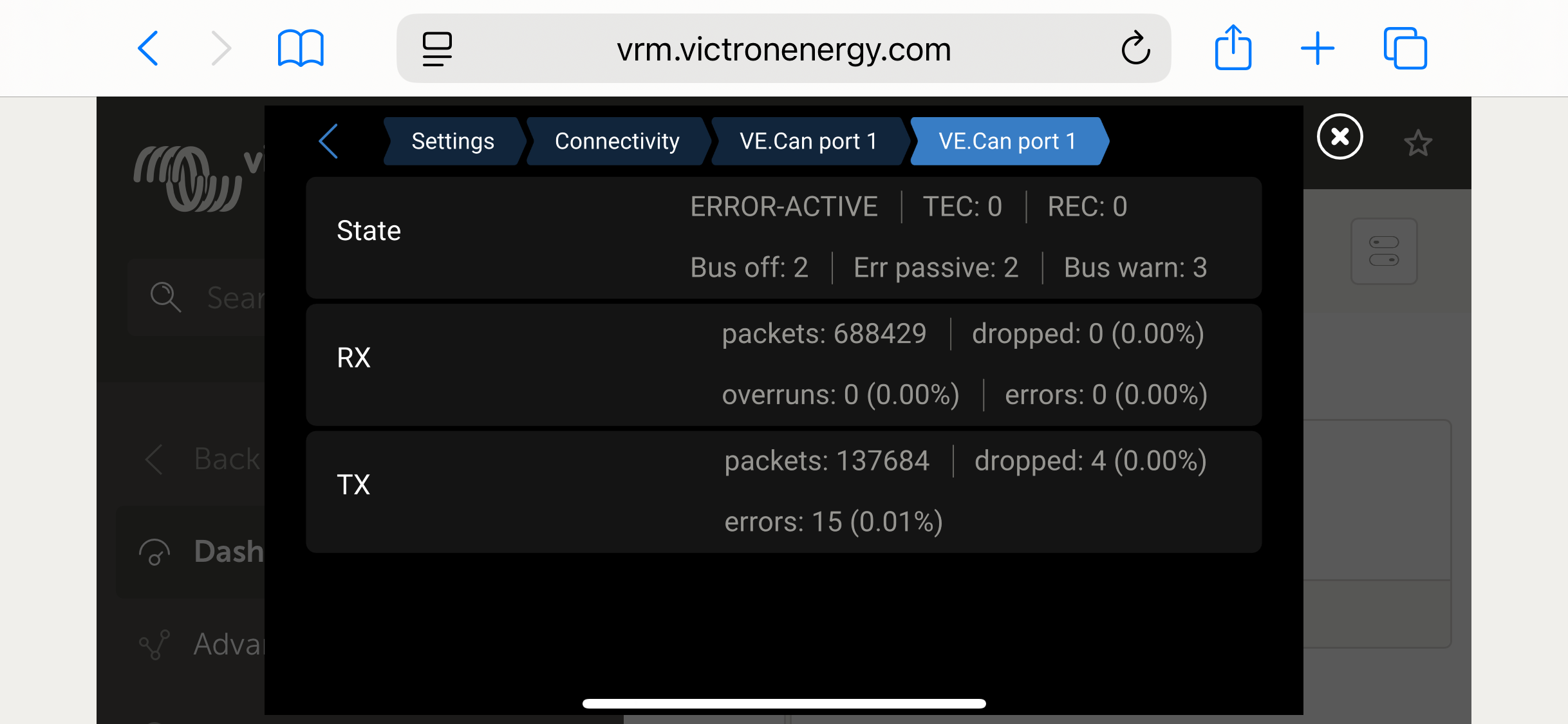

I have reconnected as you said, except I have not terminated the second port in the multi rs. Everything seems to be working fine though!
I have a few errors/warning on the CAN-bus BMS LV (500kbit/s), but I guess it occurred during installation an set-up:
Will keep monitoring to see if it keeps adding more warning/errors…
Thank you,
marco
Nice to hear its working now
