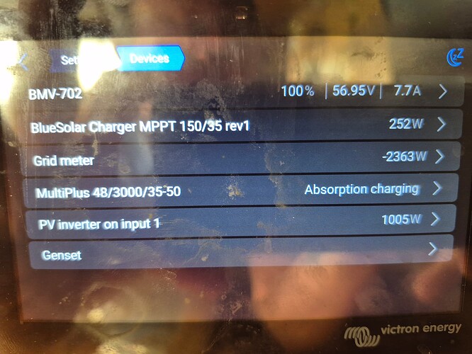

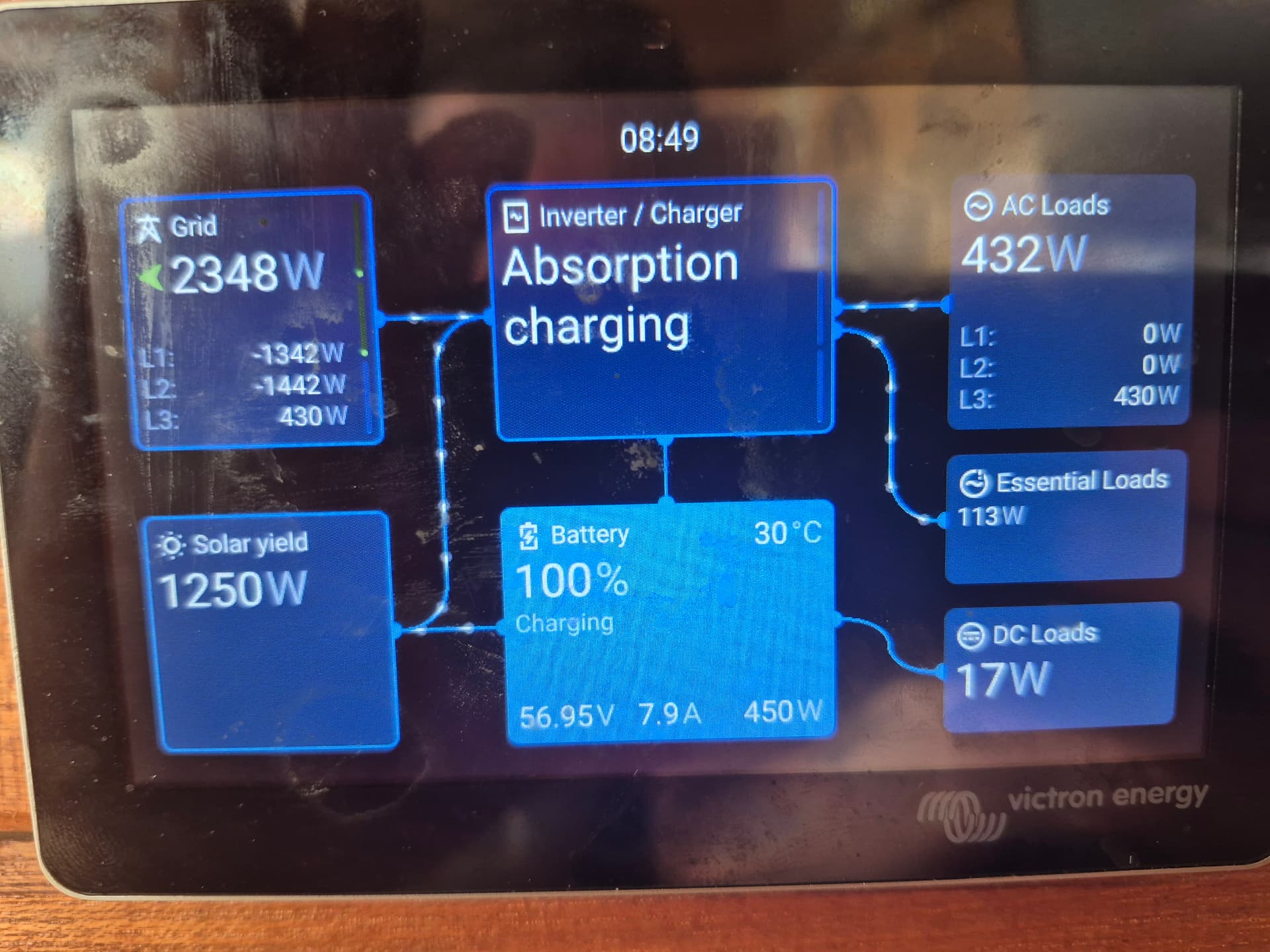

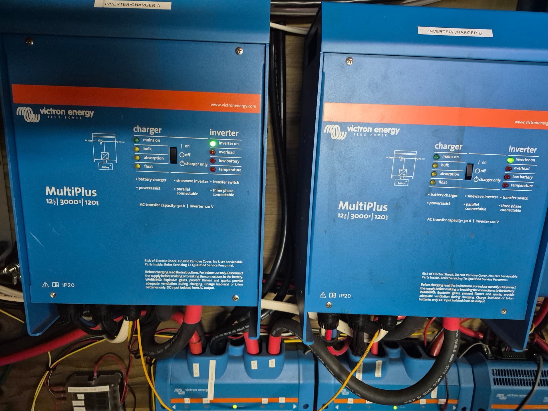

I have two Multi-Plus 12/3000/120 setup for 240 US mode. Been working fine for 2 years. This morning all of a sudden I lost AC, Muti-Plus said low battery (they were not they were at 62%) rebooted the Muti-Plus, same thing, rebooted everything and now the Cerbo says my Muti-Plus is a 48/3000/30-50 and that the batteries are at 100% (they are not) and I’m feeding 3 phase AC to the grid (it is not).
What just happened??
Another Note; The BMS is recording the correct Battery level when I log into it via the Bluetooth
And another note: I have a Lynx Smart BMS. The Cerbo is saying it is a BMV-702… Has my cerbo gone bad?

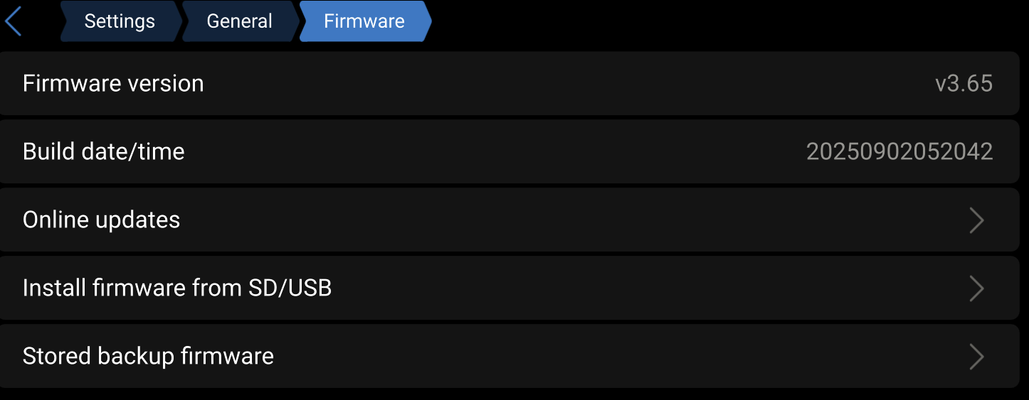

is it possible to update to the latest 3.65?
Already on 3.65

I hope you’re looking at the right GX device because 56.95V on a 12V system would be kind of bad.
Maybe start with disconnecting MPPT devices.
Very sharp! Didn’t looked at that…
Okay, for reasons unknown, the cerbo had switched into ees demo mode. I turned off demo mode and it’s fine now.
