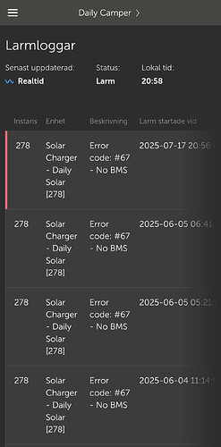

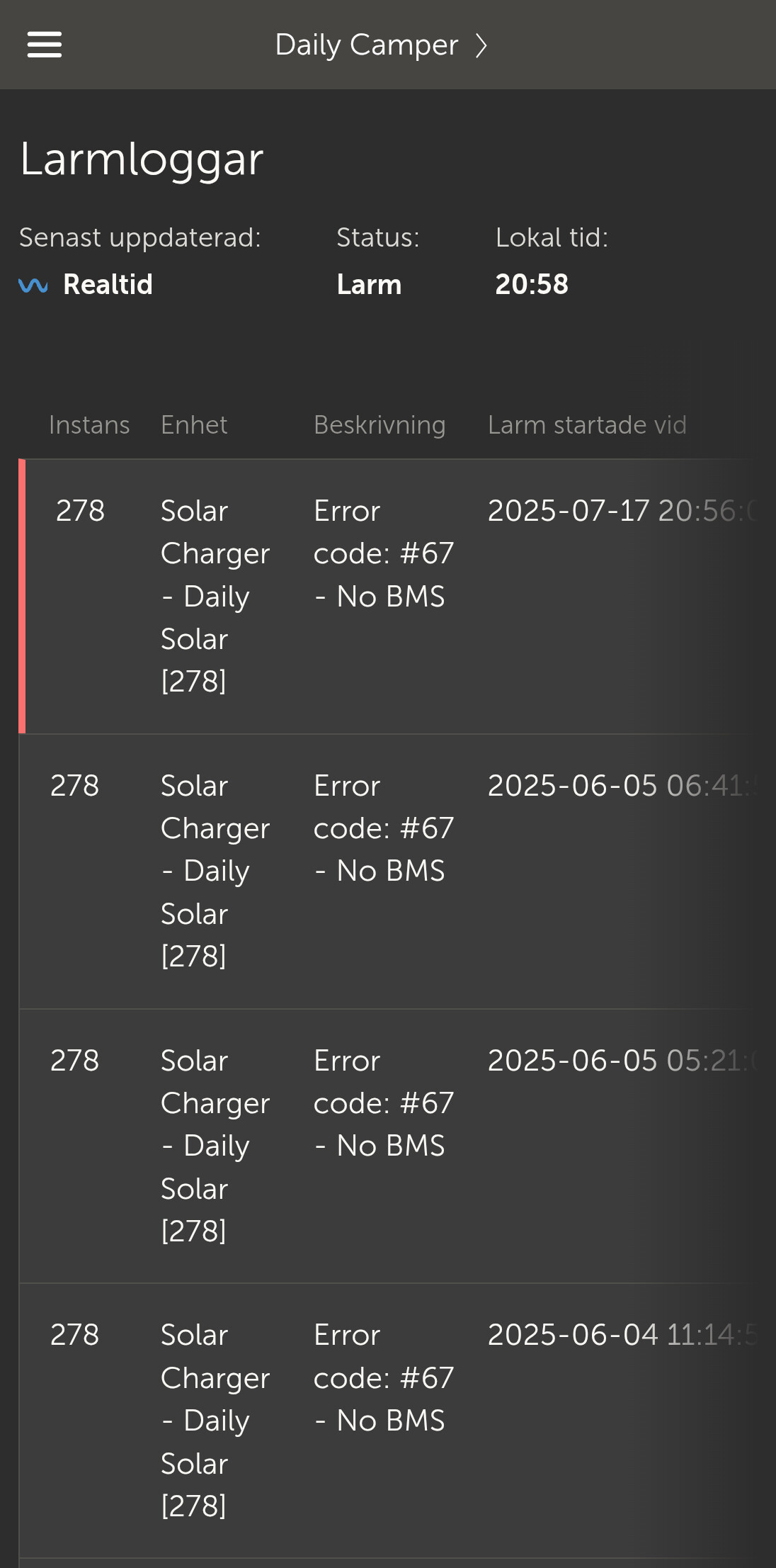

I get this alarm now and then…
I’ve checked all cables and connection, but I don’t understand.
What is Error code #67 -No BMS
