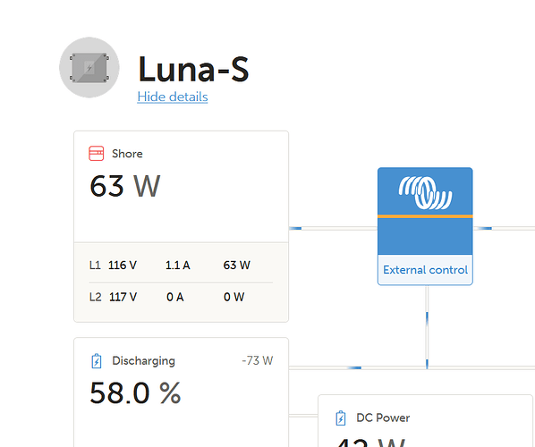

Ok maybe I just don’t understand what is going on. So does MPII actually support monitoring line 1 and 2 from the pedestal. Maybe I have only ever had line 1 activity. That seems odd though. What it means is my fridge and my bedroom AC don’t show up on my Cerbo GX touch display. Meaning I would have to have an energy meter to see line 1/2? Sigh.
I’m pretty sure your Multiplus only has a single line input. The MP 2x120 handles both shore lines.
I’m learning as I go. So I understand MP2 supports 50 amp line 1 line 2 the question is what is needed to be able to see the actual wattage coming in on line 1 and ine2. I see you display lines L1 and L2 but do you have any special setup for that, meaning an ESS? Again I understand I could be completely wrong.
Nothing special, a 24V Multiplus-II 2x120 and Cerbo on the AC side. No ESS, it’s in my coach. The MP 2x120 has 50A pass-thought and inverts on both L1 & L2 but only at 120V, no split phase 240V.
I don’t have any experience with the external energy meters. Not sure if you’d need a 3 phase meter to get split phase power, or just add a single to help your Multiplus watch the other side.
