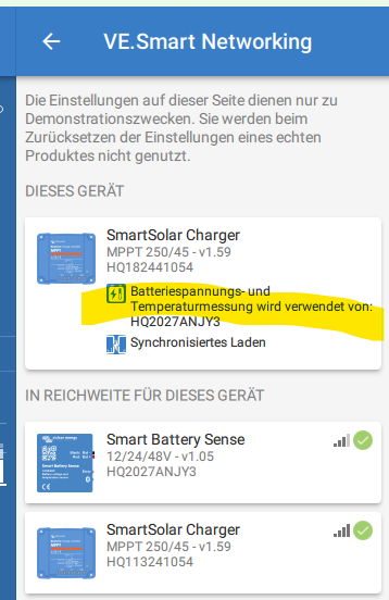

Yes, the battery temperature is considered and charging is shut down at 5degC. If there is no external sensor then the MPPT temperature at dawn is used, hence a networked senor is better.
Hopefully your battery BMS has this function anyway.
You could have checked this as noted above by going to the VicttonConnect app and using the demo library ans choosing the SmartSolar 100/20 to see the available settings with a lithium battery.
You don´t need the non-inverting cable between BMV relay and SmartSolar Ve.Direct port if you are using VE.Smart Network with a BMV temperature sensor!
The temperature is distributed via the network and the solar charge controlle switches off by software if activated.
Thank you. You’re absolutely right!
I could swear this option wasn’t available in the VictronConnect App last time I checked… but maybe I oversaw it.
That means the BMV relay remains free for some other application.
