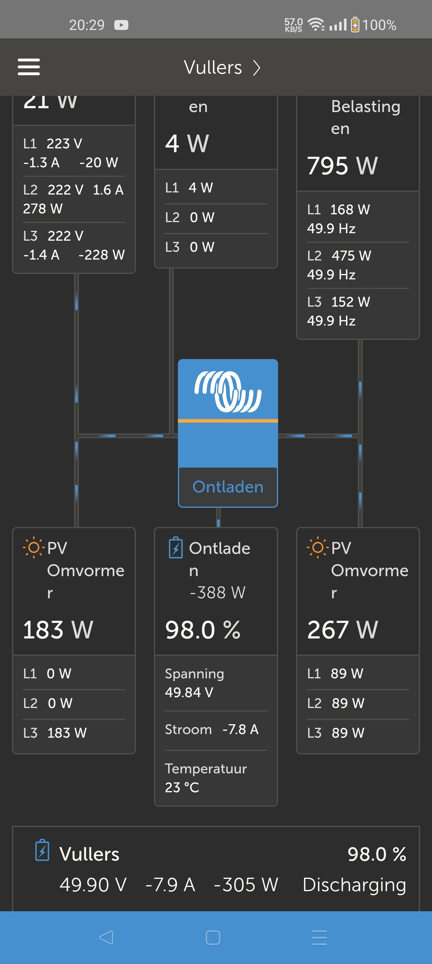

Hi, I want to add an extra EM24 to add a 1 phase solar panel to VRM display, is this possible on AC side?. Solar panel is already present on AC in but not visible on overview.

I can not recall being able to select on which side connected, it was automatically on AC out because of using ESS assistant with pv. That’s why I wonder if the 2nd pv will be on AC in.

EM24 (2nd one) added to system on phase 3. Deliberately put it on phase 3, used 3 phase settings on meter because it’s physical connected to that phase. If you put 1 phase settings them you need to set it on phase 1.
