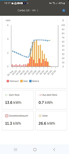

Why is the MP no longer charging the batteries, even though 13.6 kW was being fed in?

After the initial installation in May or June, I reached 100% several times (and far too soon). I therefore reduced the charging voltage to reach a maximum SOC of around 80%. However, I can no longer reach that level at the moment.

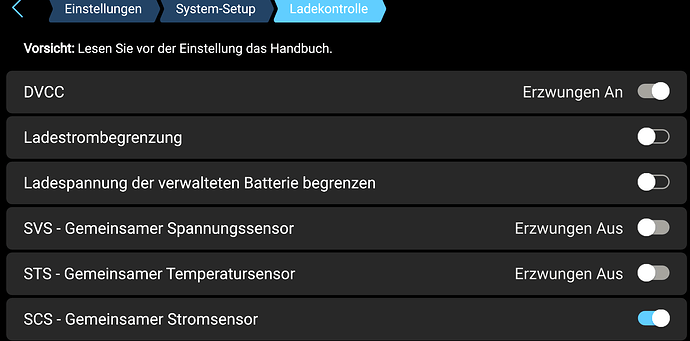

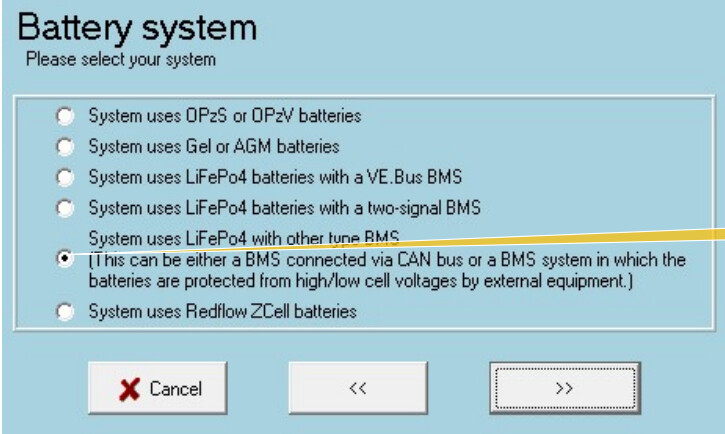

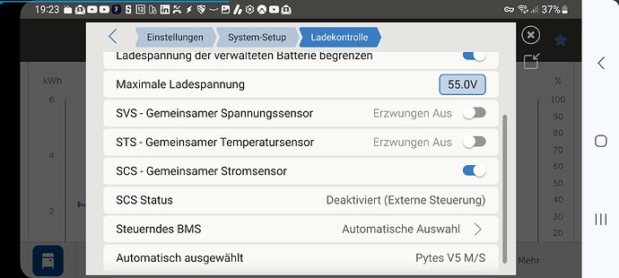

This setting in VE Configure had already been made:
I had adjusted the other parameters and disabled Limit charging voltage (just showing the relevant section here):
The state of charge immediately showed 100%:

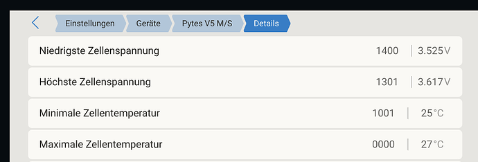

After about an hour, two cells had drifted apart by 90 mV.
The voltage was 56.8 V at that point (dbus-spy).
I stopped the whole thing for now. But at the moment, I don’t know what I should do.

You also have the charge current limit set to OFF. Is that specified in any Victron document?

DVCC should look like this:
If it doesn’t, you have old firmware somewhere here too.

At the moment, the cells are around 20–30 mV apart in the “fluctuating (cells changing)” state. Should I still set it to “keep charged”?

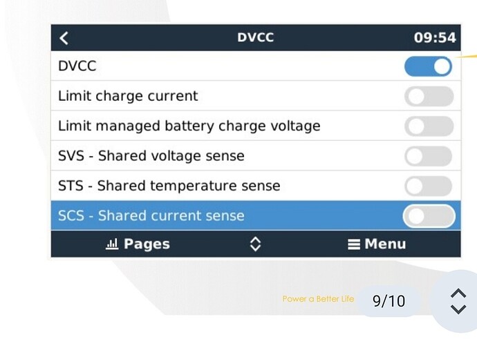

Here is a screenshot from the manual:
You have SCS – common current sensor set to ON. What is the reason for this? Don’t both batteries then receive the same current?
Panda Solar also referred to the manual, where SCS is set to OFF…
30 mV is fine and you can enable it again.
-> I’m not the one who enables that; Victron or Pytes does it automatically. Since that isn’t happening for you, you must have outdated firmware somewhere.

SCS is irrelevant, as it doesn’t play any role anyway. See the column one further down on your side.

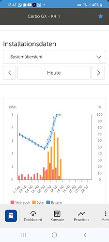

Now I’m back to having the situation where the storage is full by midday and just twiddles its thumbs at 100%.
It should really only be full in the evening and then immediately feed the electricity back into the house!

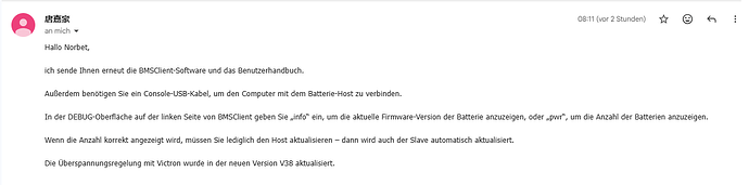

I received a reply from Pytes.
The overvoltage control with Victron was updated in the new V38 version.
You only need to update the host — the slave will then be updated automatically as well.
The latest BMSClient version is 2.1.7
