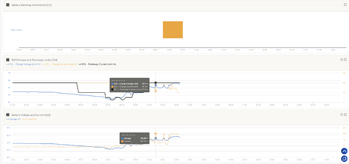

Unfortunately, I keep getting a warning that the charging current of my Pytes e-box-48100R is too high for my three Multi RS Solar 48/6000 units.
What’s strange is that the maximum charging current specified by the BMS briefly drops from 100 A, which triggers the warning.
What could be causing this? Could it be the BMS?

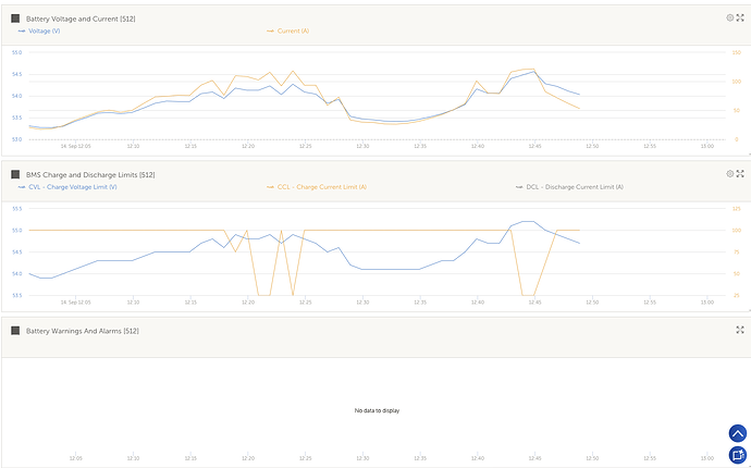

Hello @PytesEnergy sadly I sill get some warings about high Chrage Currents.
What’m asking me, is this maybe an issue of the GX device and not an batterie BMS one?

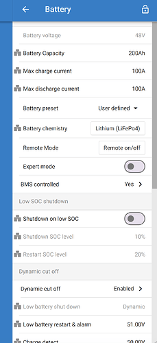

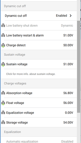

I used these settings as a guide
The inverter settings are overridden by the BMS, what they are set to is irrelevant when connected to a managed battery. If you are getting high-voltage warnings from the battery, only the battery can be the cause as it is sending the charge parameters and reporting the issue.
