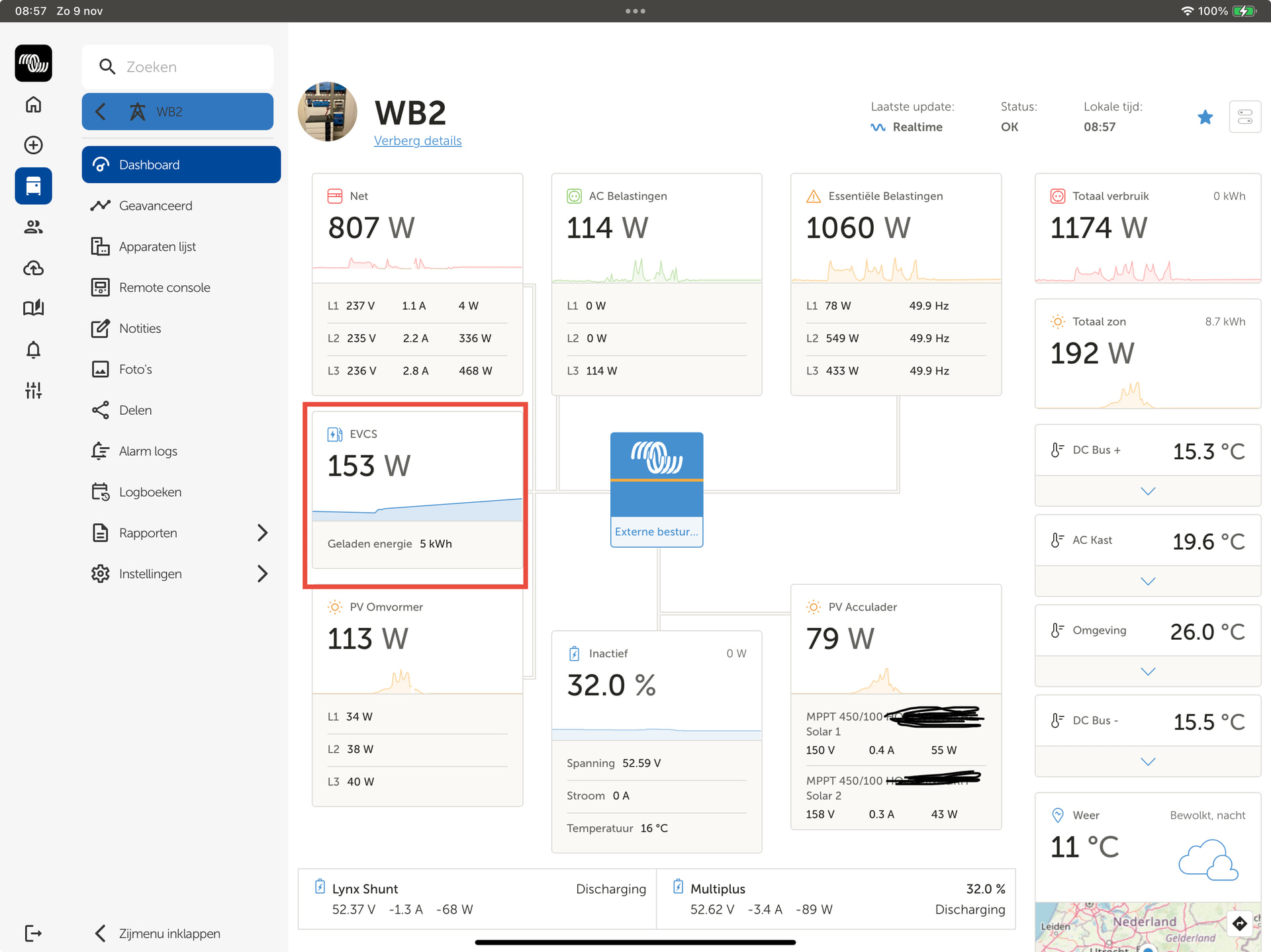

Infromation needed. I do have my 3 phase heatpump with EM24 connected and role is set to Heatpump. When doing this the tile nor any other information from the heatpump shows up on the dashboard/reprting etc. EM 24 shows the data.
Heatpump does show up in device list with own instance number etc.
To have the data available I now set the role to EV charger and then all data becomes available, however this doens’t look the correct way.
Is this a known issue or setting issue?
I would like to have the Role: Heatpump with it’s own tile on the dashboard and advanced reporting etc.

This feature has been criticized many times and is currently being worked on… unfortunately, a WP is not yet possible graphically in the Remote Console or VRM overview… only via your “workaround” via EVCS.
