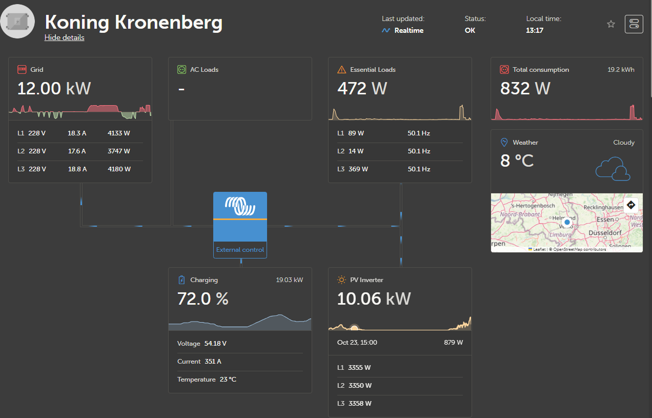

I used this energy meter VM-3P75CT before for my solaredge inverter. But after integration of solaredge with victron this energy meter was not needed anymore. I use this energy meter now for the heat pump. However when I used the same energy meter in the role of PV inverter it was presented in VRM and GUI. But now I use this energy meter in the role of a heat pump and I donot see anything in VRM or GUI. See picture below. Is this how it is implemented or do I something wrong?
Currently this feature is not available, see this thread.
I made that thread too, but was about another issue about forecasting and that is solved with new software. Therefore I opened this new thread.
Yes must have been removed change the role to EV so you can see it in the VRM for now, at least you will be able to see the load
