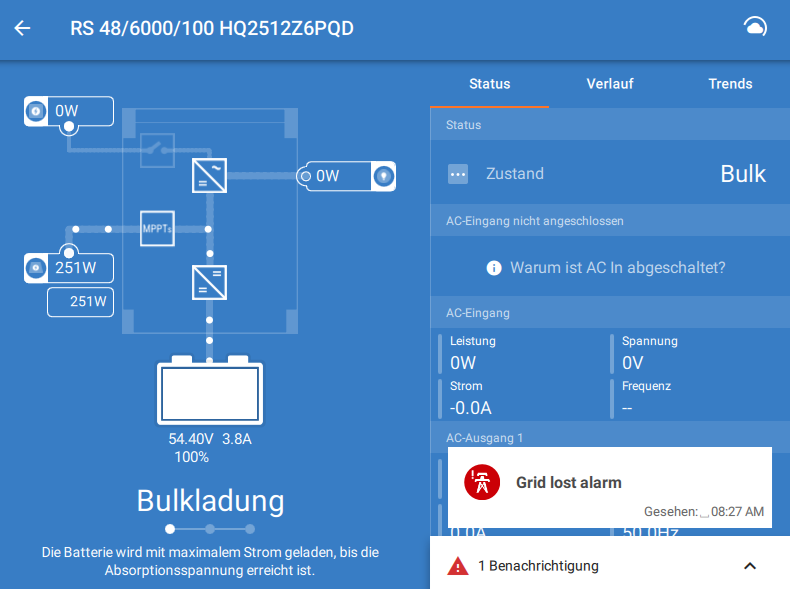

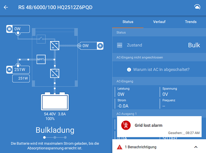

Hello,
The grid lost alarm on the RS is still on in the VictronConnect.
Any idea when you can solve that? It should be a configurations to toggle on /off this alarm.

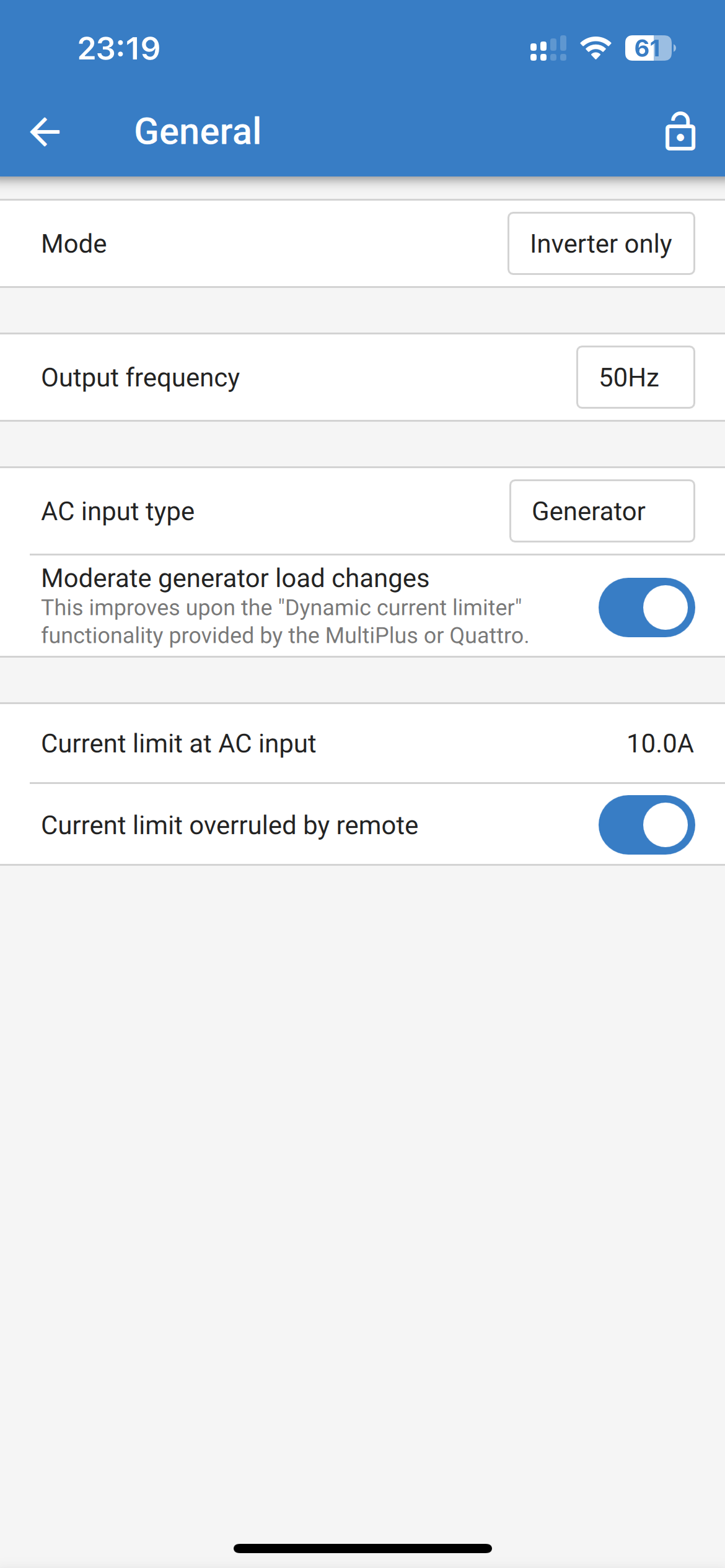

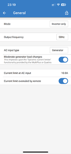

Same in the past. Now I changed the settings and don’t get the notification Grid lost alarm.
Before:
General → Mode: Inverter only

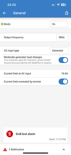

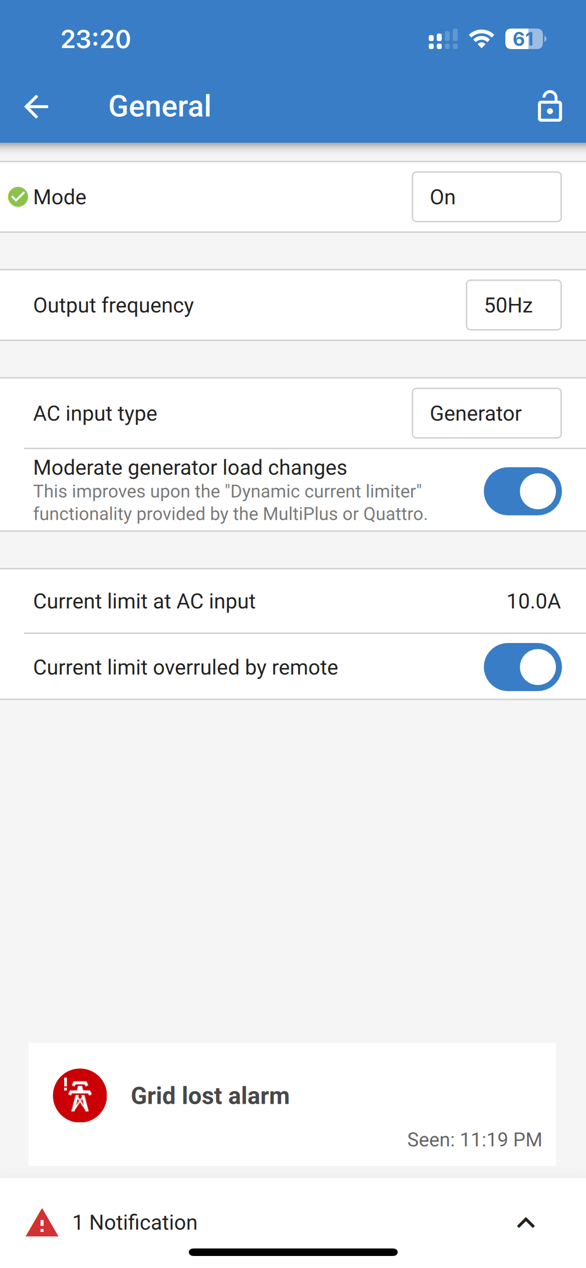

Hi, I changed the same settings and don’t get the notification.
How do you have set the Cerbo → Settings → System setup → Monitor for grid failure ?
In the end, I believe it’s logic for it to work if you set the Inverter only mode, because in the Inverter only mode the grid is disconnected by default and then there is no point in monitoring the grid…
