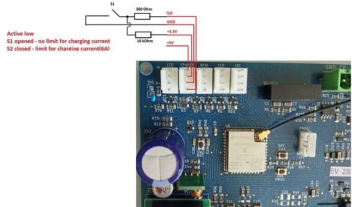

The EVCS apparently has an input that can be used for this. At least, that’s what was announced at one point; unfortunately, there still presumably isn’t any documentation whatsoever.

This is how it needs to be implemented:

Just a quick note, since people will probably find this thread via Google as a starting point: as of now, the 300-ohm resistor is no longer mentioned in the EV Charger instructions.
As mentioned, a software update is required and can be downloaded via Victron Prof.

Which 4-pin connector fits on it?
I don’t have such a wallbox, so my assessment is based solely on the photo above.
It looks like the Molex KK series. If the pins have a 2.54 mm pitch, one of these should fit.
https://www.molex.com/content/dam/molex/molex-dot-com/products/automated/en-us/salesdrawingpdf/269/2695/022013047_sd.pdf?inline
I’d probably go for the 2695-4RP.
https://www.digikey.com/en/products/detail/molex/0022013047/26435
The corresponding pins are listed further down under Associated Products.
That would be useful information to include in the manual.
Molex KK-254 MX 2.54 mm
These fit my setup and are now installed.
