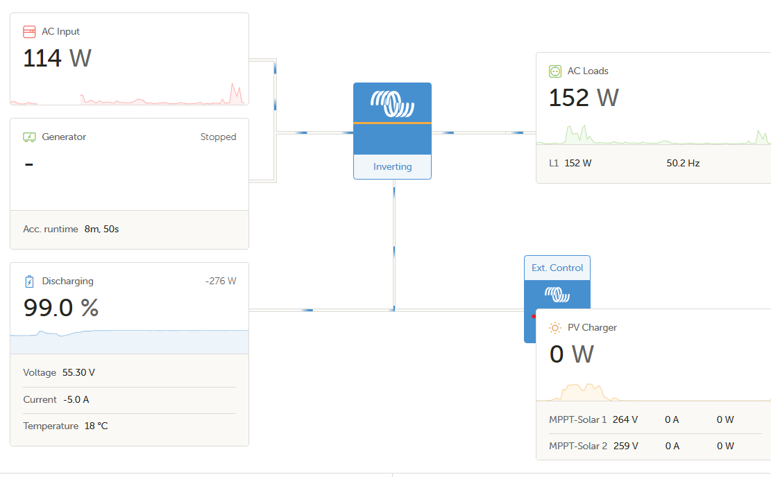

I have noticed some changes.
Normally the SOC is between 75 and 80% by 07:30. It is now 100%.
There is no power from the PV Charger.
I normally change the inverter mode to inverter only and hence stop the power coming in from the grid.
The PV Charger then starts bringing in power.
I have just (07:40) switched the mode to On and the PV Charger does not bring in power. 100 - 120W coming from the grid.
What has changed, and why?
Mode: On
Mode: Inverter only.

Managed to get that sorted out.
The problem was when I tried upload the last VE Config file an error message came up indicating that is was not compatible with the firmware - a direct link between the firmware and the VE Config file.
This meant I would have to download the default VE Config file on the VRM Portal and apply the settings from the last VE Config file.
I opened both files and ensured I appled the settings from the old file and then uploaded.
It is looking good so far with a little (30 - 100W) power being fed in from the grid.
I will need to check tomorrow morning to see if ESS #1 and 2 display when the SOC is below 100%.
