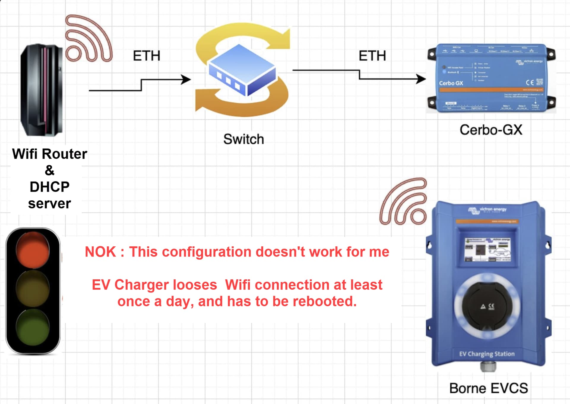

Long story short, it looks to be a poor Wi-Fi implementation in the EVCS Charger ( Espressif32 module), that causes the abrupt WiFi disconnection. The ESP32 implementation does’nt appear to be fully compatible with smart Wi-Fi technology, such as Mesh or Wi-Fi 6.
Here is a drawing showing what is
NOT working, in my case (The router is a mesh type Wifi 6)
I have set up an additional Wi-Fi access, point dedicated solely to the EVCS terminal, few meters away from the charger, connected to Ethernet. The AP replaces the Wi-Fi router to communicate with the EVCS.
