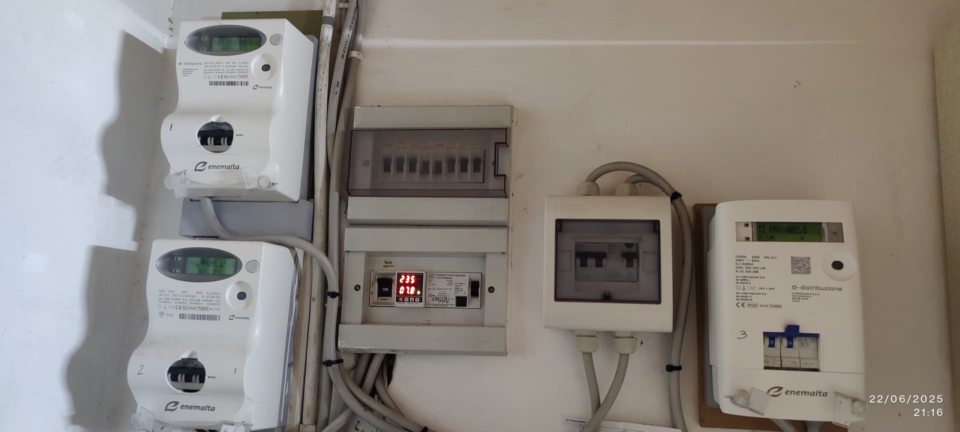

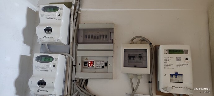

The energy meters we use in Malta are Italian from Enel, and at the moment I have two energy feed in tariff meters attached to the main one. A photo of the energy meters uploaded.
But now I am replacing the feed in tariff meters with with the ET112 energy meter. The feed in meters have to be removed since the local energy supplier charges rent for them. The AC supply is through my two Multiplus in parallel from their input connection only. Is there any current limiting factor in this regard. Thanks SteffenNetrange for your help.
