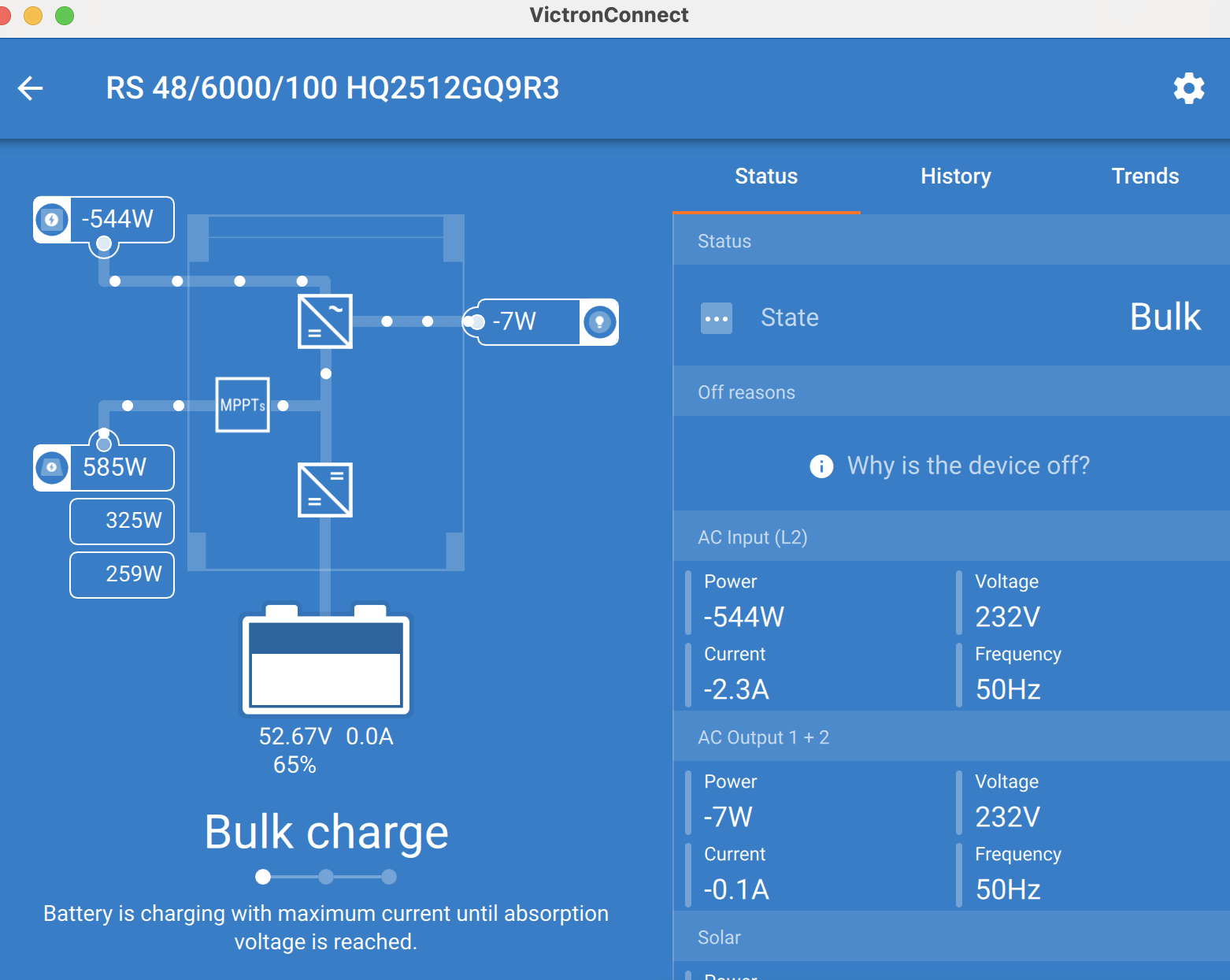

I haven’t adjusted anything, and after about six months, my grid meter no longer seems to be used by the Multi RS solar panel.
The values ​​normally displayed on the Multi RS were the grid meter, but now it’s the Multi RS’s internal measurement output.

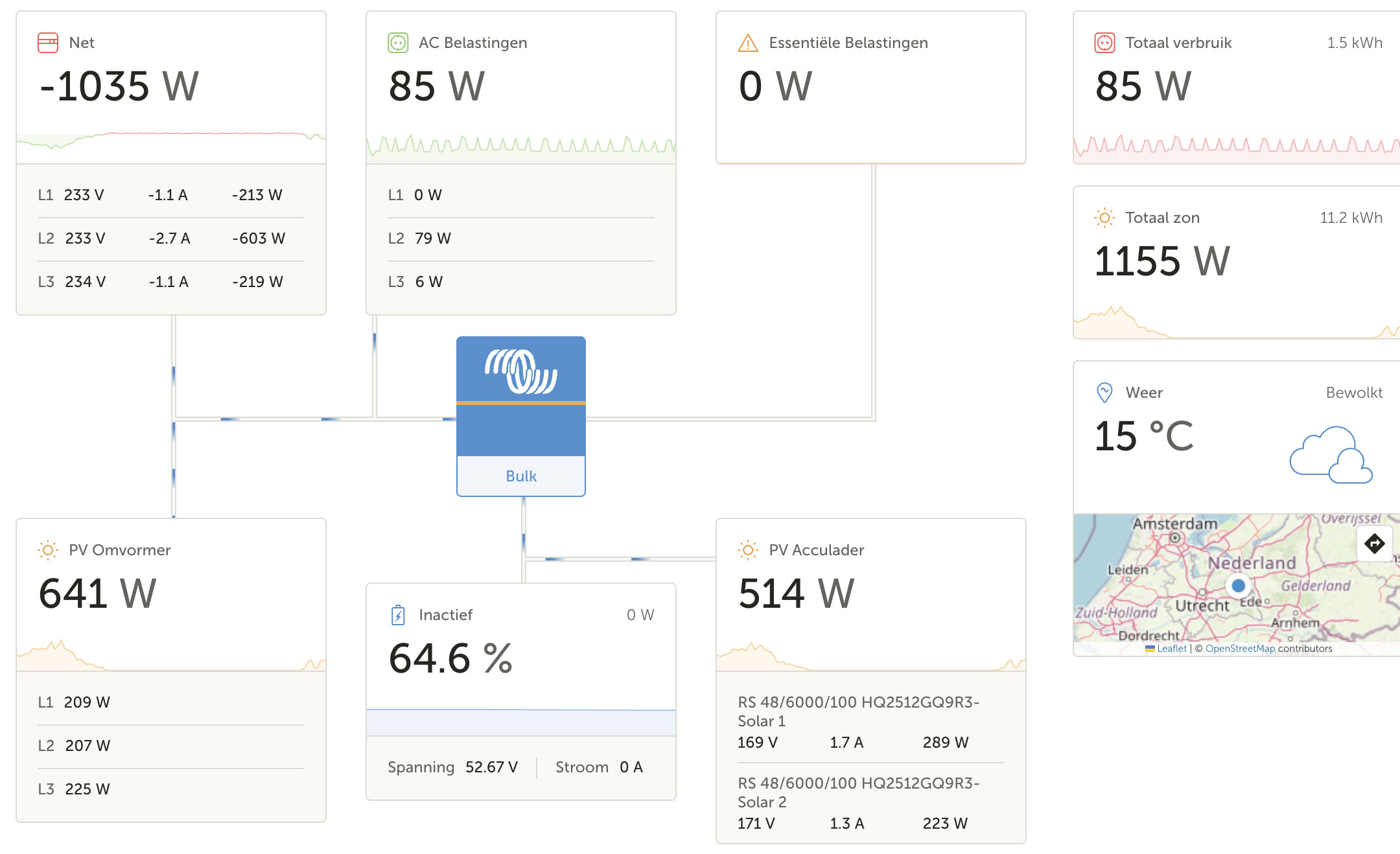

Everything seems normal in the Cerbo and VRM, and the grid meter data is correct.

The current currently flowing from the Multi RS is from the solar panel connected to the RS.

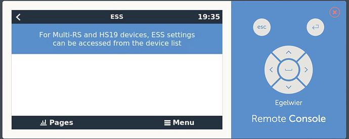

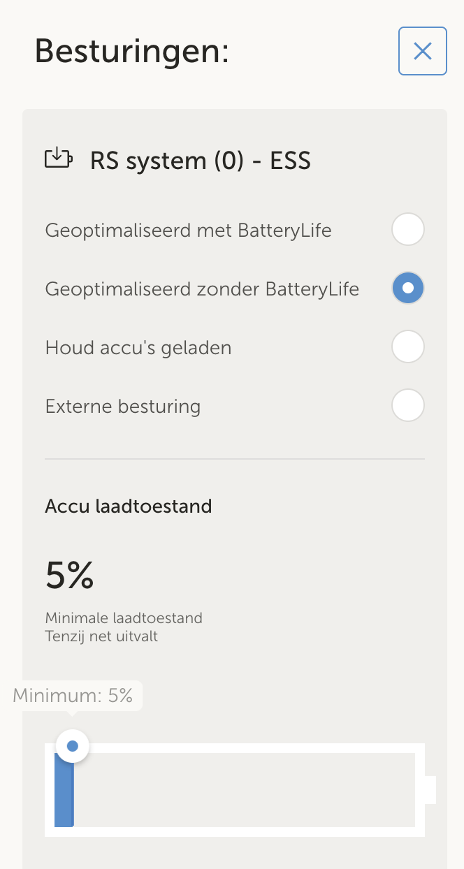

Can you check if the grid meter is set to external in the VRM remote console under settings>system setup>ESS ?
Just to make sure, you did not update the inverter?
Update of the inverter is week back, ESS setting is nog here with the Multi-RS
