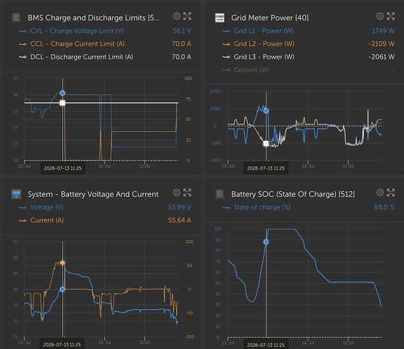

That’s what it looks like. Can anyone explain this? No errors on the system.

You can also go back in the VRM overview to compare the data … and how did your system reach 80% SOC the previous day?
I’d say the BMS is limiting it to 52.7 V… But why? I’d check the BMS settings.

Quite right, the voltage issue should have stood out.

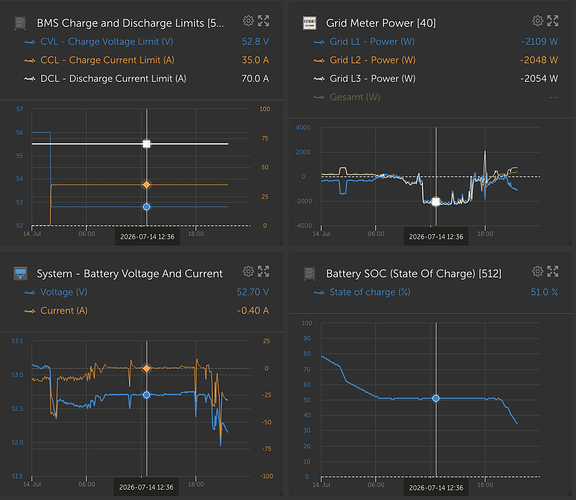

Here are the last two days; yesterday was fine. So the settings should be correct too—I’d already sent them to REC before. In any case, I’m now seeing exactly what I wanted. I’ll send the screenshot to REC Support.
That looks good … you can post your VE-Configure configuration file here sometime … then we can have a look through it :face_with_monocle:
What do you mean? When it’s running, it looks good. But I still don’t have an explanation for why the BMS lowers CVL at 50% SoC, and does so irregularly.
The VE Configure part would only be interesting because the Multi acts as a charger … but as you can see, your BMS lowers the charging voltage and sets the current completely to 0 even though the SOC isn’t 100% … do you have temperature sensors on the BMS that could be responsible for this? …
Temperatures are usually between 30 and 35 degrees. It doesn’t correlate with the behaviour, and there’s no alarm showing on the BMS either—nothing in the logs, either.
